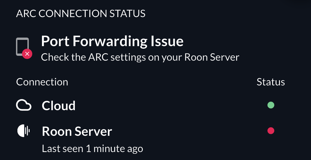

If Roon ARC can’t communicate with your server from outside the home, you’ll see a message like this in Settings:
This is because Roon wasn’t able to automatically configure your network for port forwarding.
There are two solutions. The first solution is to manually configure your network to support port forwarding. This article will guide you through that process.
