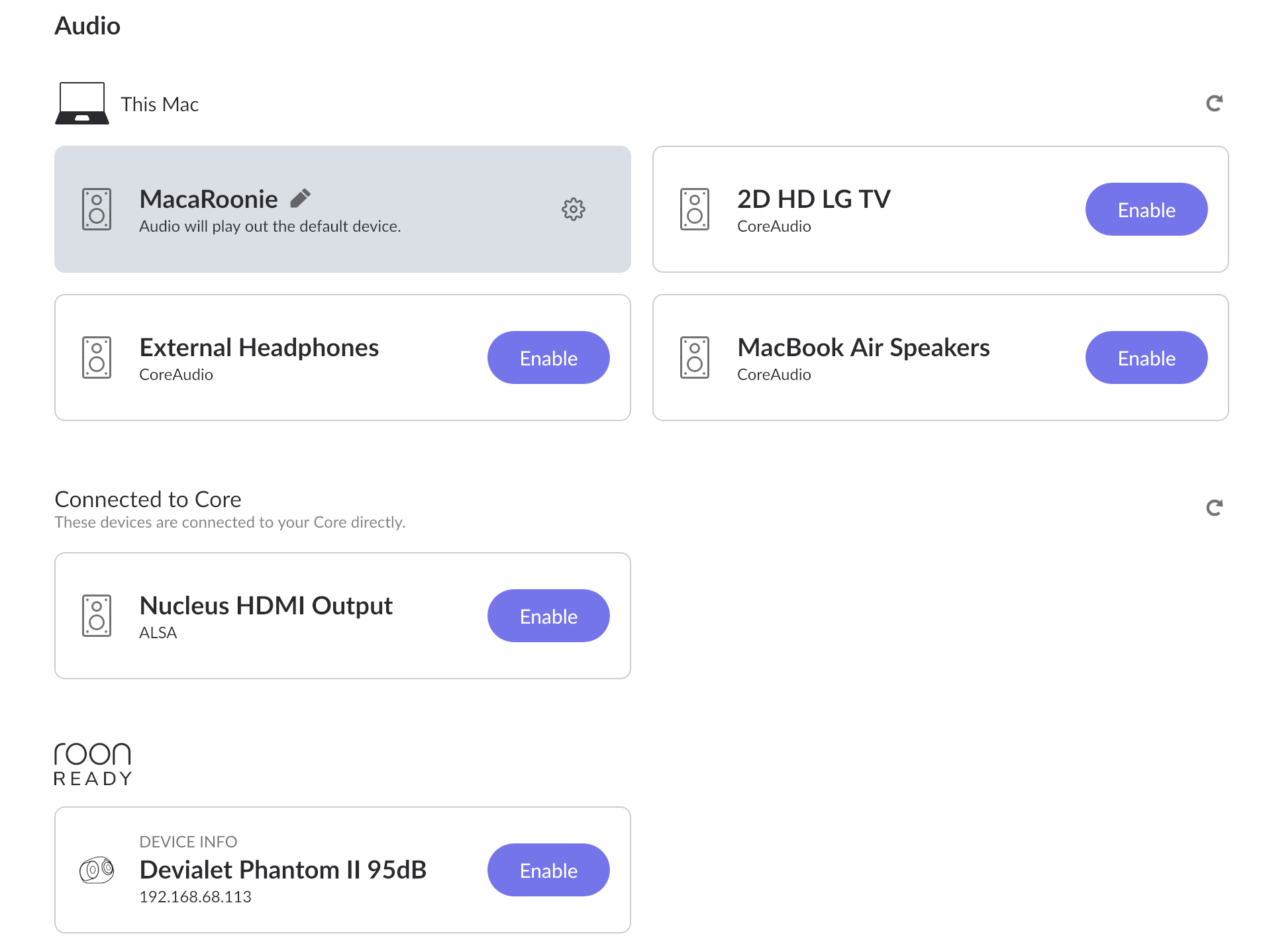

Accessing Audio Settings
To access audio settings, click the settings cogwheel  from the navigation bar, then choose the Audio tab. Inside the Audio tab, you'll be presented with a list of audio output devices, grouped by type, and in some cases, by which computer or device they are connected to:
Device settings can be accessed by clicking the Gears icon or the "Enable" button. A device must be enabled in order to play music in Roon. Enabled devices will appear as Zones within Roon.

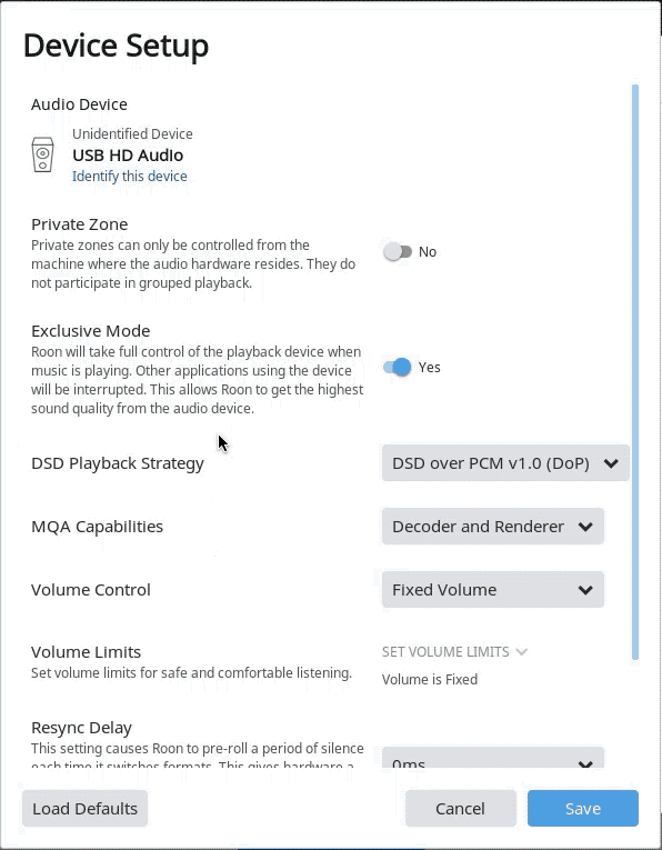

Device Setup
This is the Device Setup screen. It is split into two categories, general and advanced. If your device has been automatically identified by Roon, all of the correct settings should be applied automatically without any extra configuration by the user needed. You can always return the settings to their default state by clicking Restore Defaults. Nothing is saved until you click Save Settings so feel free to exit the dialog if you get things into a confusing state and want to undo your changes.
Device Identification
Roon will automatically identify many Roon Tested USB DACs and apply the optimized settings and device icon. If your Roon Tested DAC is not automatically identified, you can manually identify it using our "Find Your Device" device picker.
General Settings
Private Zone
Private Zones can only be controlled from the same device where the audio hardware resides, and they are completely invisible to other devices. This also means that they cannot participate in Zone Linking. This setting is most commonly used for private, or single-user devices like phones and tablets, where it often doesn't make sense to allow other members of the household control playback.
Exclusive Mode
The Exclusive Mode setting tells Roon to take exclusive control of your audio device. In order to playback MQA or DSD content, this setting must be enabled. See Exclusive Mode for more information.

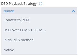

DSD Playback Strategy
If you didn't go out and buy a "DSD DAC", or you don't know what that means, leave this setting at the default "Convert to PCM" value and feel free to skip the following:
If you did buy a DSD DAC, this is the approach we recommend:
  1. If Roon offers "Native" as an option, set it up that way and try out some DSD files. If everything works, great you're done. If things do not work, unplug your USB cable, and power cycle the DAC--some DACs misbehave after failed attempts at Native DSD playback.
  2. If "Native" playback wasn't an option or it didn't work, try "DSD over PCM v1.0 (DoP)".
  3.  If that doesn't work, you either:
    1. Don't have a DSD DAC after all
    2. Have a bit-perfect playback problem
    3. Have a very rare and early DAC that needs the "Initial dCS method" setting. If your DAC wasn't manufactured by dCS, this probably isn't you

Volume Control Mode
There are a number of options here, and they vary by platform. For more information on platform-specific options, see the platform-specific audio pages, linked at the bottom of this page. There are a few options that pertain to all platforms. Those, we'll describe here:
Use Device Controls
This causes Roon to pass volume commands on to your device via the device's driver. Exactly what happens next varies from device to device. If your device advertises a high-quality volume control over USB, it's likely that this is the setting that you want.
DSP Volume
Uses Roon's built-in 64bit dithered volume processing. This is a high-quality option, but should not be your first choice for hardware that provides volume control natively.
Fixed Volume
Disables volume control from within Roon, sending a fixed-level output signal to the audio device. Use this setting if you plan to control volume elsewhere--for instance, on your preamplifier or AV receiver. It's there to solve problems--if you don't have problems, you don't need it!
Generally, the problems this solves are phrased like "I'm not getting full-volume output even though I have Roon set to Fixed Volume mode or the Software Volume slider is at the maximum", or sometimes "I'm not getting bit-perfect playback, even though I'm in Fixed Volume Mode". Maybe your device's controls are being manipulated by other software or by the OS, and you want Roon to set them back to a known state each time. Maybe your device boots up at 20% volume every time, and you need Roon to reset it for you. Whatever the case may be, if you're having problems like that, try this setting out and see if it helps.
Automatically sleep device
Auto Sleep automatically puts supported devices into “standby” mode if you haven’t played anything recently. After going into standby, your device can easily be “woken up” just by playing content in Roon.
This setting will work with Roon Ready devices that meet the above criteria, as well as devices from Devialet, Linn, and Meridian. It will also work when an extension-provided source control with the same capabilities is available on the zone.
Resync delay
This setting is primarily used when a S/PDIF, AES, or I2S connection is involved. Oftentimes, a DAC will take a little bit of time to lock onto a new audio signal--sometimes as long as a few seconds.
This setting causes Roon to play a configurable duration of silence whenever it begins a new stream. Like the last setting, this one is a problem solver. If you find that the beginnings of songs are being cut off, or you're getting a lot of clicks and pops while your DAC locks on to an S/PDIF signal at the start of playback, try increasing this setting. 500ms is a good starting point. If that doesn't work, try gradually increasing it from there.
We default this to a very small value because it produces delays in Roon's user experience. Consider that when setting it up--unless you have an uncommonly slow DAC, settings longer than 1-2 seconds are probably unnecessary.

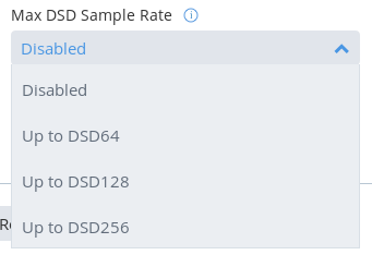

Max DSD Sample Rate
This setting is for devices that over-represent their DSD capabilities.
If there are high DSD rates that your device doesn't support, you can use this setting to establish a maximum rate. That way, Roon will convert higher-resolution DSD content to PCM before playback instead of trying to play it directly.
This setting is a problem solver--if you don't have that problem, leave it at the default.
