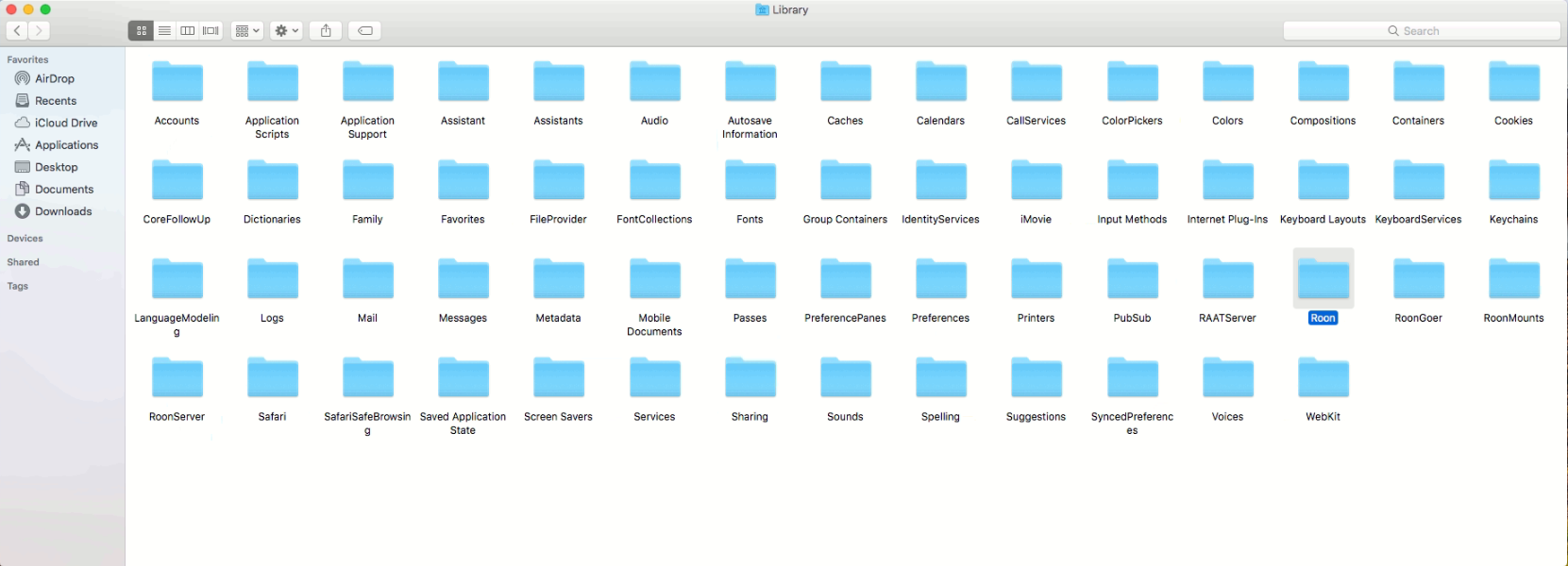

macOS Server
  1. Open Finder and click Go in the top bar
  2. Hold down the Option key (or Alt)(⌥) to unhide the Library folder
  3. Click the Library folder
  4. Find and open the Roon or RoonServer folder

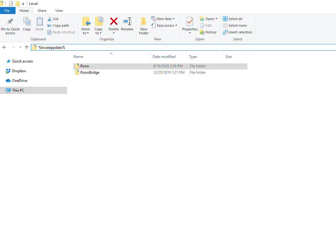

Windows Server
  1. Open Windows Explorer
  2. Click in the address area, type %localappdata%, and hit Enter
  3. This will redirect you to your local app data folder, e.g. C:\USERS\USERNAME\AppData\Local
  4. Find and open the Roon or RoonServer folder depending on install type. The Database folder is a subfolder found inside the Roon or RoonServer folder.

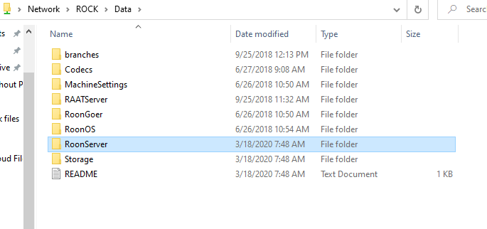

ROCK Server
Using a Windows machine, open File Explorer and navigate to \\ROCK\Data and use Guest as the username and password. You should then see the RoonServer folder.
