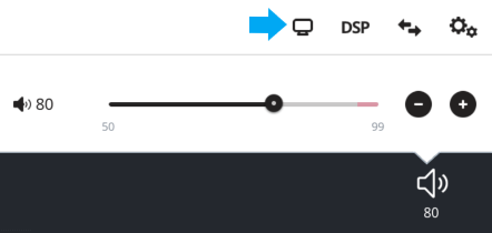

To show what you're listening to on a Chromecast device, click the Displays button in the volume popup.
The Roon volume popup with the Displays button highlighted
Notes
If you don't see the Displays button, you may not have any Displays available on your network, or none are enabled yet. Please check Settings > Displays.

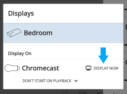

You'll see a list of Displays on your network. Click Display now to start showing Now Playing information.
The Displays window for the Bedroom zone, listing a Chromecast with the Display now button

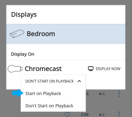

To use the Display every time you play music in this zone, choose Start on playback from the menu below the Display.
The Displays window menu with Start on playback and Don't start on playback options

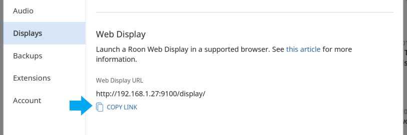

Step 1: Copy the Web Display URL
  1. In Roon, go to Settings > Displays.
  2. Under Web display, click Copy link next to the Web display URL.
  3. Open the link in your web browser.

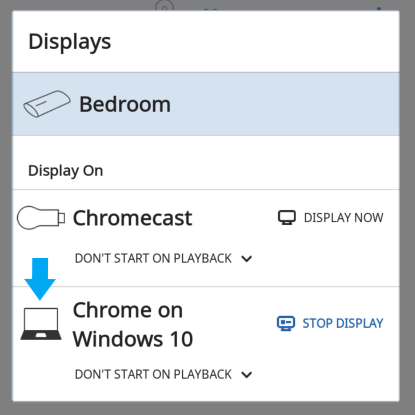

Step 2: Choose the Browser as a Display
Once the browser is open to your Web display URL, it appears in the Displays window just like a Chromecast device. Open the zone's Displays window from the volume popup, as shown above.
The Displays window for the Bedroom zone, listing a Chromecast and a Chrome on Windows 10 web display with Stop Display
Info
Web Display supports Chrome, Safari, and Firefox. Edge also works, but may not perform as well. Internet Explorer isn't supported. If you're having issues with other browsers, please let us know.

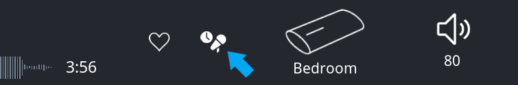

Roon has lyrics for millions of tracks, with timing data for many that lets us sync lyrics to the track as you listen. When a track in your library has Real-time Lyrics, you'll see a small clock next to the lyrics icon.
The Real-time Lyrics icon, a small clock next to the lyrics icon
The Now Playing bar showing the Real-time Lyrics icon highlighted next to the Bedroom zone

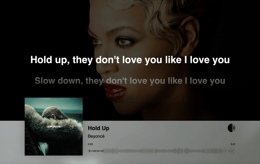

When you play a song with Real-time Lyrics, your Display shows the lyrics on screen, scrolling along with the song.
A Display showing scrolling lyrics over the artist photo, with album art and track details below
