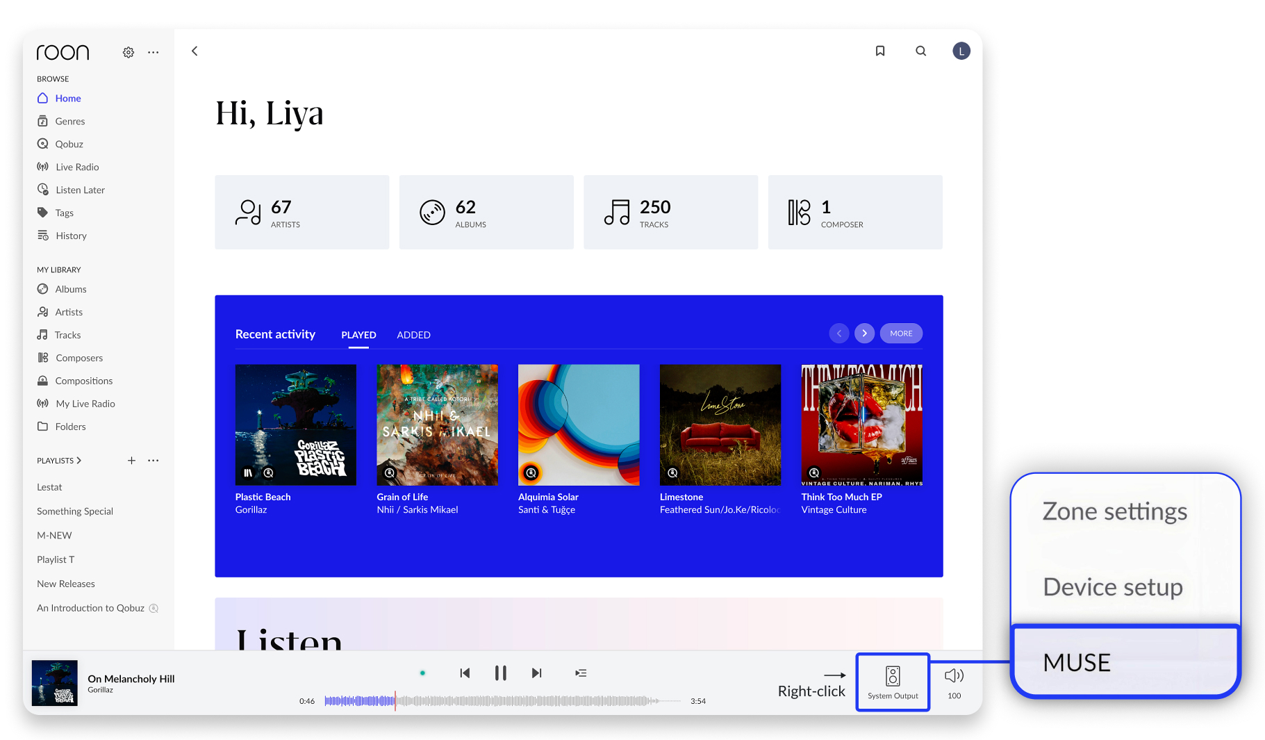

  1. Open MUSE for the zone you want to configure. There are several ways in, including your volume controls, right-clicking or long-pressing the zone icon, and Signal Path. The full list is in Accessing the MUSE suite.

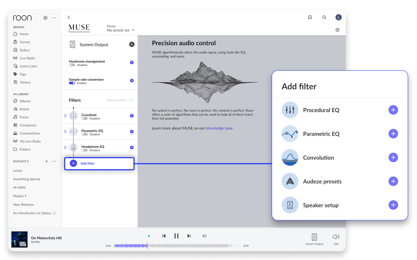

  2. Scroll down the MUSE sidebar to Filters.
  3. Click Add filter.
  4. Click the + beside Procedural EQ.
  5. Click the blue chevron on the new Procedural EQ row.
The Procedural EQ panel opens with an empty operation list and an Add operation button at the bottom.

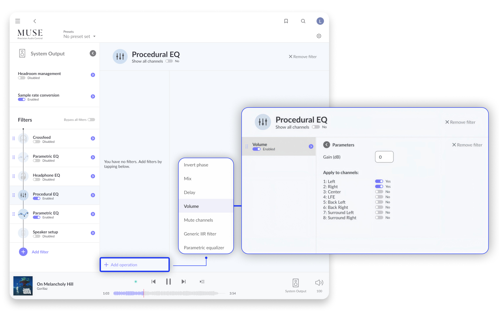

Each operation in the list has three controls:
  • A drag handle on the left. Drag an operation up or down to change where it sits in the chain.
  • An Enabled toggle. Switch an operation off to hear the chain without it. This is the fastest way to audition a change or to find a CPU-hungry operation.
  • Remove filter, at the top right of the operation's panel, which deletes it.
Click Add operation to add another. Seven operation types are available: Invert phase, Mix, Delay, Volume, Mute channels, Generic IIR filter, and Parametric equalizer. Each is documented below.

Volume
Applies a fixed gain to the selected channels.
Use it to balance levels between channels, or to attenuate one leg of a crossover. Gain is limited to the range -24 dB to +24 dB. Values outside that range are clamped to the nearest limit.
ParameterTypeDefaultDescription
Gain (dB)Numeric, -24 to +240Gain applied to every selected channel
Apply to channelsToggle per channelLeft and Right onThe channels the gain is applied to

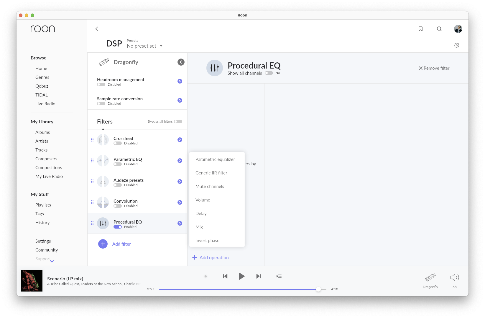

Generic IIR filter
Applies a single biquad filter from coefficients you supply.
This is the lowest-level tool in MUSE. Use it when you're building a digital crossover and already know the filters you want, expressed as coefficients. For ordinary frequency response adjustments, use the Parametric equalizer operation instead: it's the same class of filter with a usable interface on top.
Places a full parametric equalizer inside the chain, applied only to the channels you choose.
This is the operation to use when you want different equalization on different channels. Add one Parametric equalizer operation per channel or group of channels, then set each one's Apply to channels list accordingly.
Click the chevron beside Filter to open the band editor. It's the same editor as the standalone Parametric EQ filter, with the same band types and controls. Please see Parametric Equalizer for the band parameters. The channel assignment sits below the Filter section on the same panel.
Roon does not include a fixed-band graphic equalizer in the Procedural Equalizer or anywhere else in MUSE. To get the equivalent of a graphic EQ, add bands at the center frequencies you want and set each one's gain.
