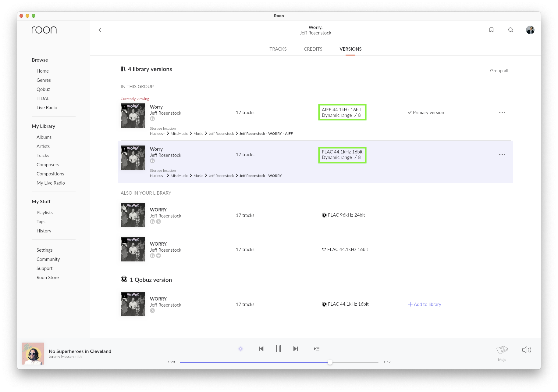

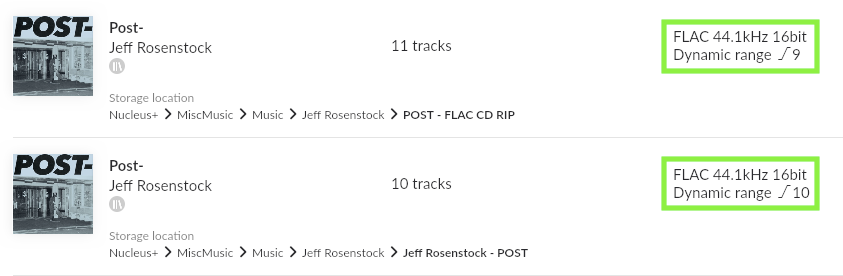

Since the early 90s, many recordings have been increasingly "louder". Since it's impossible for a CD to turn up your stereo, they increase the volume using techniques like dynamic range compression. For more information on the "Loudness War", see here. Dynamic Range measurements provide insight as to what may have been done to a recording, particularly in cases where there are multiple releases to chose from, like this:
In this case, it's clear that while both are versions of the same Hi-Res material, the CD-quality release has been processed in a way that reduced its Dynamic Range when compared to the Bandcamp version.

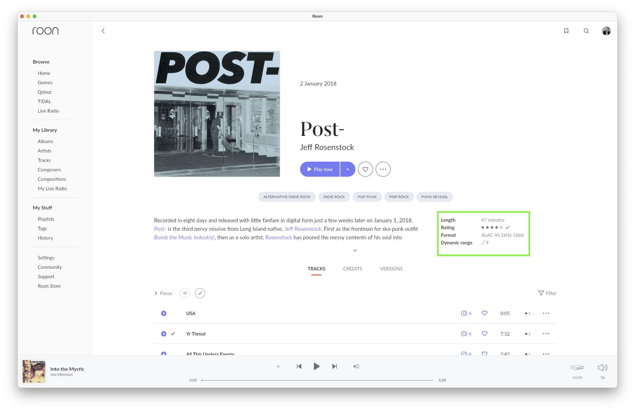

On the Album Details Screen
In the "Versions" tab when viewing an album

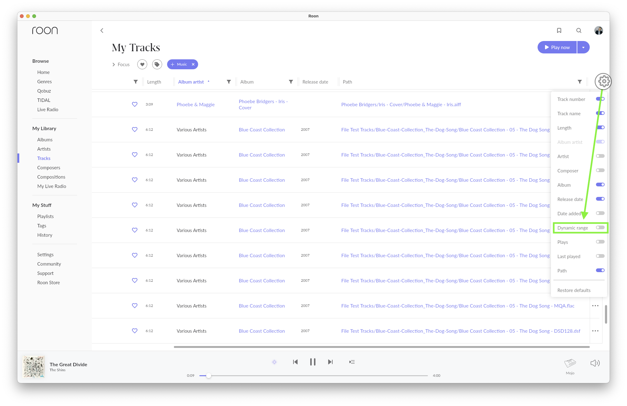

In the track browser when the "Dynamic Range" column is enabled
Click the gear icon, and then toggle the Dynamic range option when viewing your tracks
Dynamic Range will be displayed in a new column in your "Tracks" view

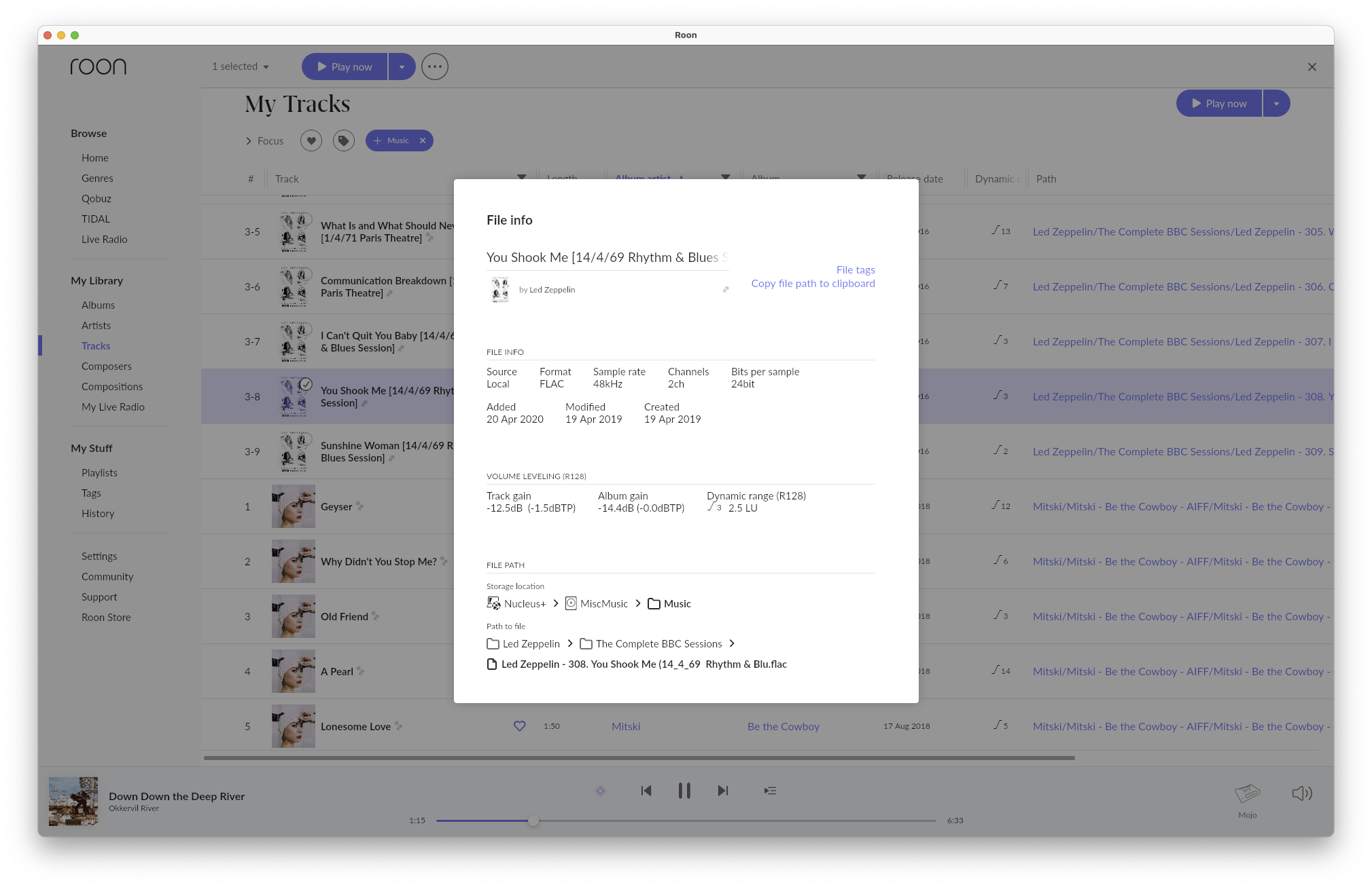

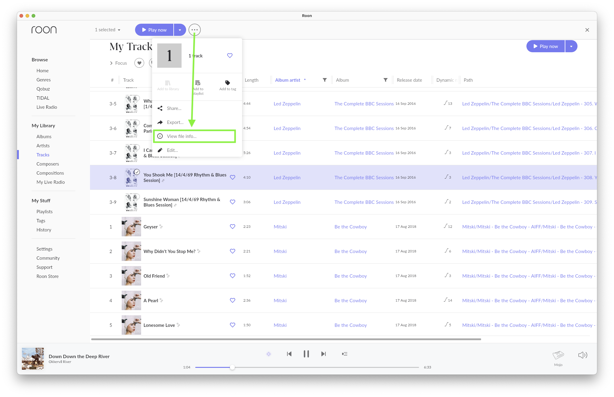

In the "File Info" popup
Right click or long press the track you're interested in, and then click the three dots (•••) menu. You'll find your file info button inside of this menu
The File info menu will display details regarding your track that include dynamic range
