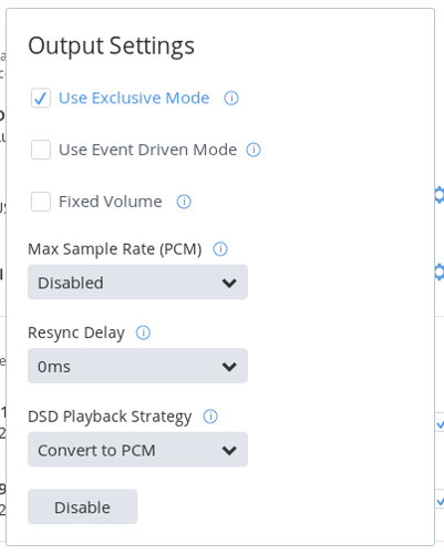

  5. A screenshot of your DACs settings in Roon. You can find these settings under the little gear next to your DAC on the Audio tab of Settings. It should look like this:
