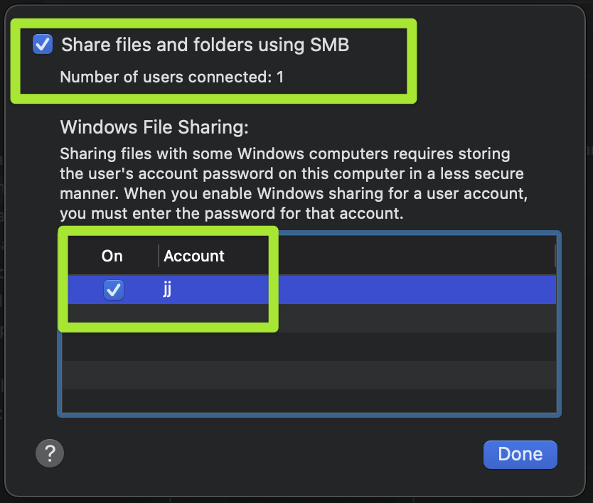

Regardless of what kind of device you're using, you'll want to make sure that the following is true:
  1. The folder is allowed to be accessed via SMB
  2. Your username and password should not contain any special characters
  3. Use SMBv3 when possible. Failing that, SMBv2 should also be ok, but do not use smb2 with large MTU as it has known compatibility issues with Roon. If you're using a Synology NAS and running your Roon Server on macOS, you can find some more information about fine-tuning your setup here.
  4. On macOS ensure that "Windows File Sharing" is enabled on the Sharing > File Sharing > Options scree
  5. Don't enable AFP or Timemachine if possible -- some users may need this functionality for other applications, but they're not needed for Roon. You can find more information about why AFP is not supported here

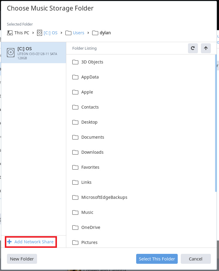

To add a networked watched folder, navigate to Settings > Storage in Roon and choose Add Folder. Next, choose Add Network Share.

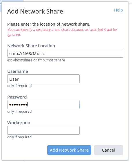

You'll then need to add the share information into Roon. Make sure that you use the correct Username and Password along with the Workgroup if the share requires it. You should be able to see the exact path for the share by viewing the share's settings on that machine. The path should look like one of these:
  1. \\NASDRIVENAME\Music (for example)
  2. smb://NASDRIVENAME/Music (for example)

If you're having trouble adding a share, please try the following:
  1. Verify that the folder is properly shared as seen in Step 1
  2. Try accessing the path via Finder or File Explorer to verify it works
  3. Remove any special characters from the share's password and try again
If the above doesn't help, you can try using the IP address to connect to the share in Roon. Note that you'll want to make sure the device has a static IP if you're connecting via the IP address. The shared path will look like this:
  1. \\192.168.0.1\Music (for example)
  2. smb://192.168.0.1/Music (for example)
If you're still having problems with setting up your NAS, let us know! Make sure to include screenshots of what you're entering into Roon, screenshots of the share settings, and a detailed description of your networking setup.
