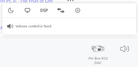

You can set a crossfade of 0-10 seconds from the Zone Picker.
Click the current zone on the right side of the bottom bar, then in the pop-up window click the speaker icon followed by the gearwheels icon to display the Zone Picker.
Click on the speaker icon for the zone, or zone group, that you intend to configure
Click on the gearwheels icon to access the "Zone Settings" panel
The Zone Settings panel is shown:
Here you can use the drop-down to set your crossfade.

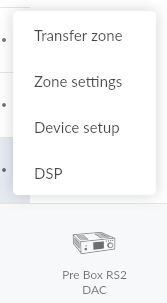

Roon Power User tip – You can also access Crossfade by right-clicking (or long-press) the Zone Picker at the bottom right of the screen. From there, select Zone Settings.
