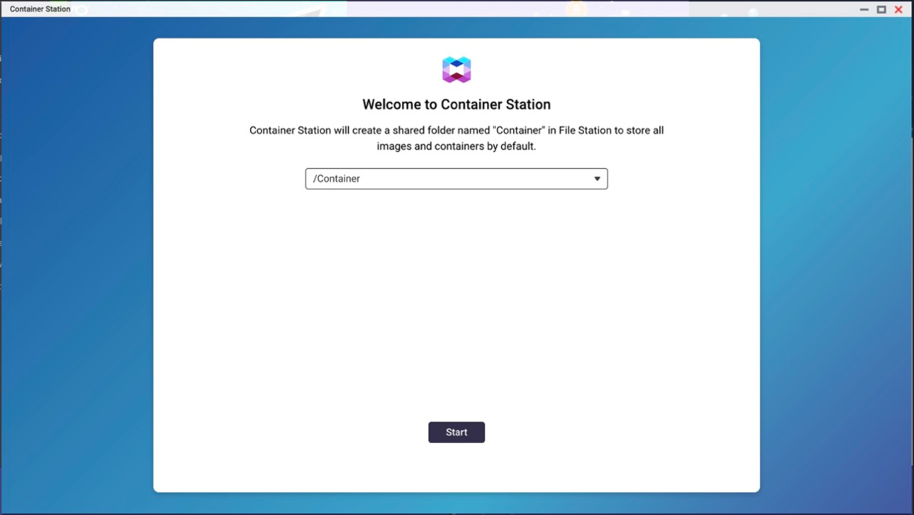

Step 1: Install Container Station
If you already have Container Station installed, feel free to skip to Step 2. Otherwise, expand this section and follow the instructions.

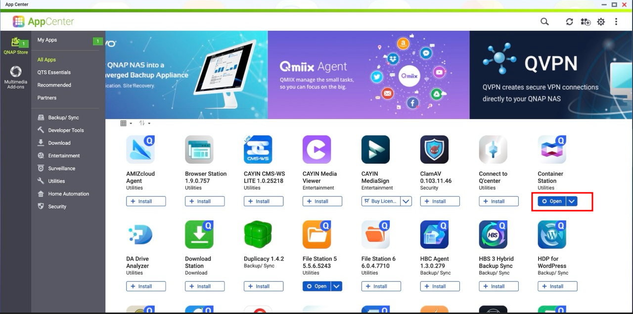

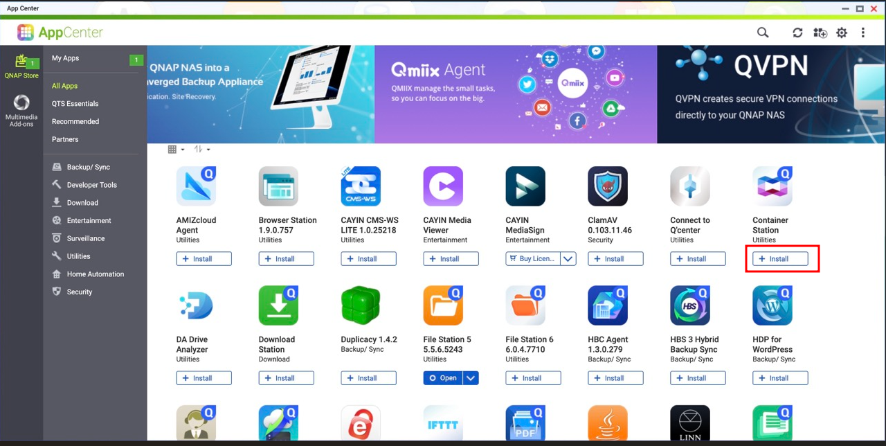

  1. Open App Center on your QNAP NAS.
  2. Search for Container Station.
  3. Click Install.
  4. Follow the setup prompts.
  5. If QNAP asks where to install Container Station, select the storage volume where you want the Container Station data to live.
Notes
Note: depending on the QNAP storage setup, especially thick or thin volumes, Container Station may ask you to select the partition or volume where the app will be installed during setup.

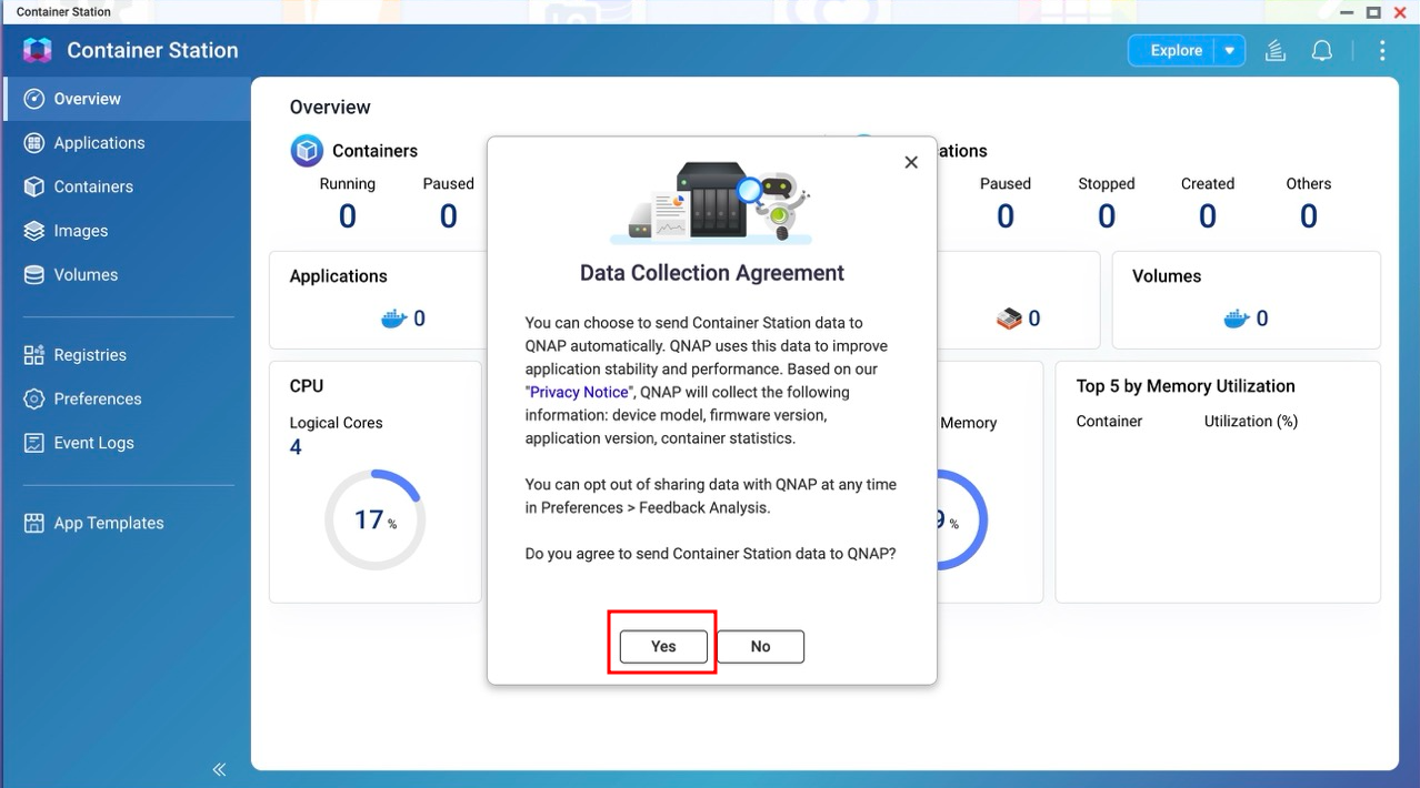

After installation is complete, open Container Station.

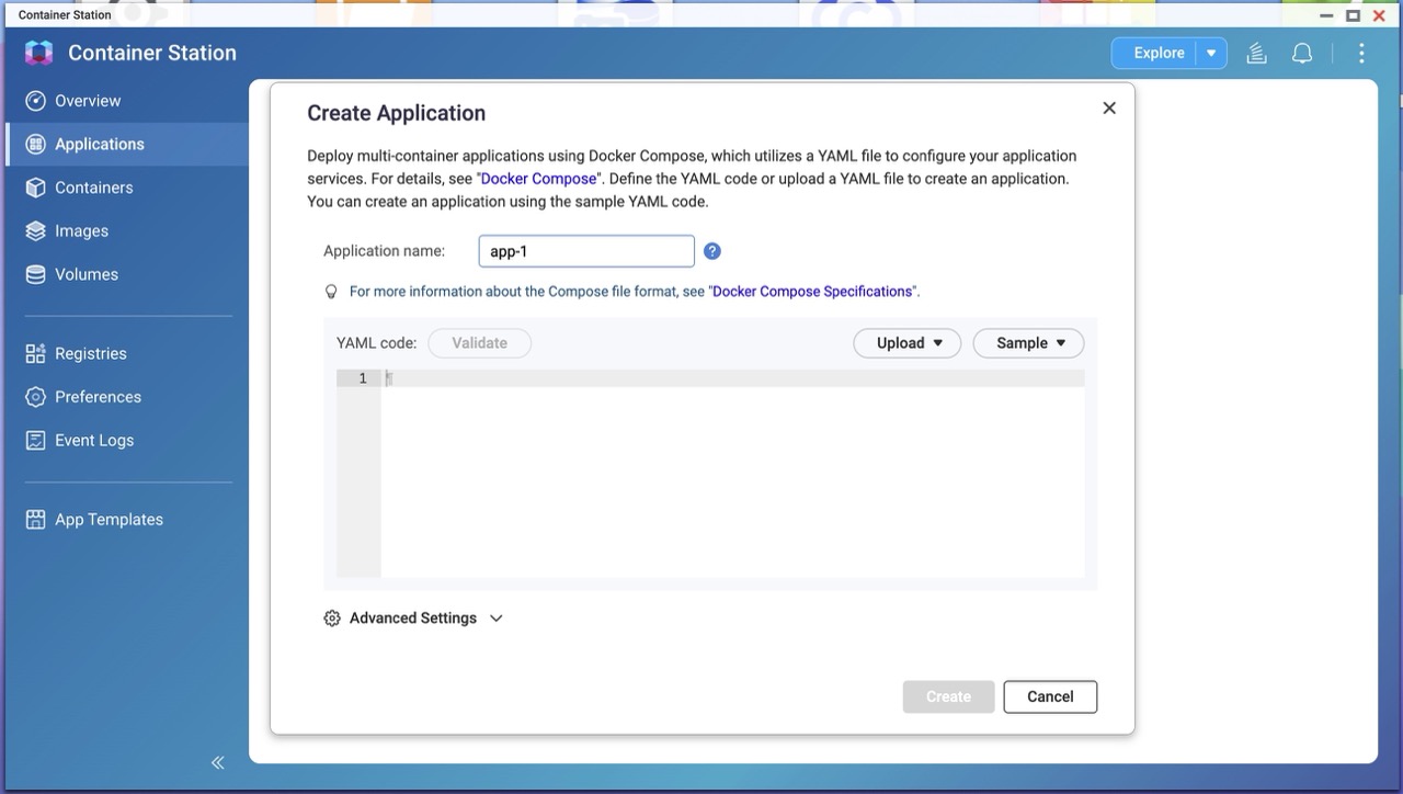

 Step 2: Create a new Application

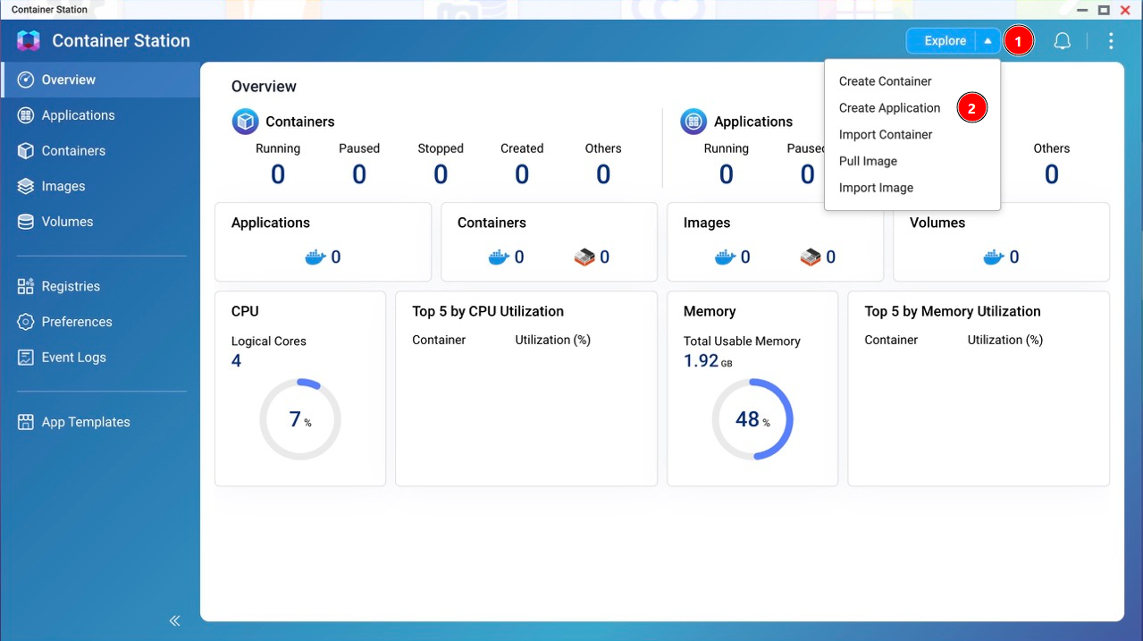

  1. Open Container Station.
  2. In the top bar near the Explore button, unwind the dropdown list.
  3. Click Create Application.

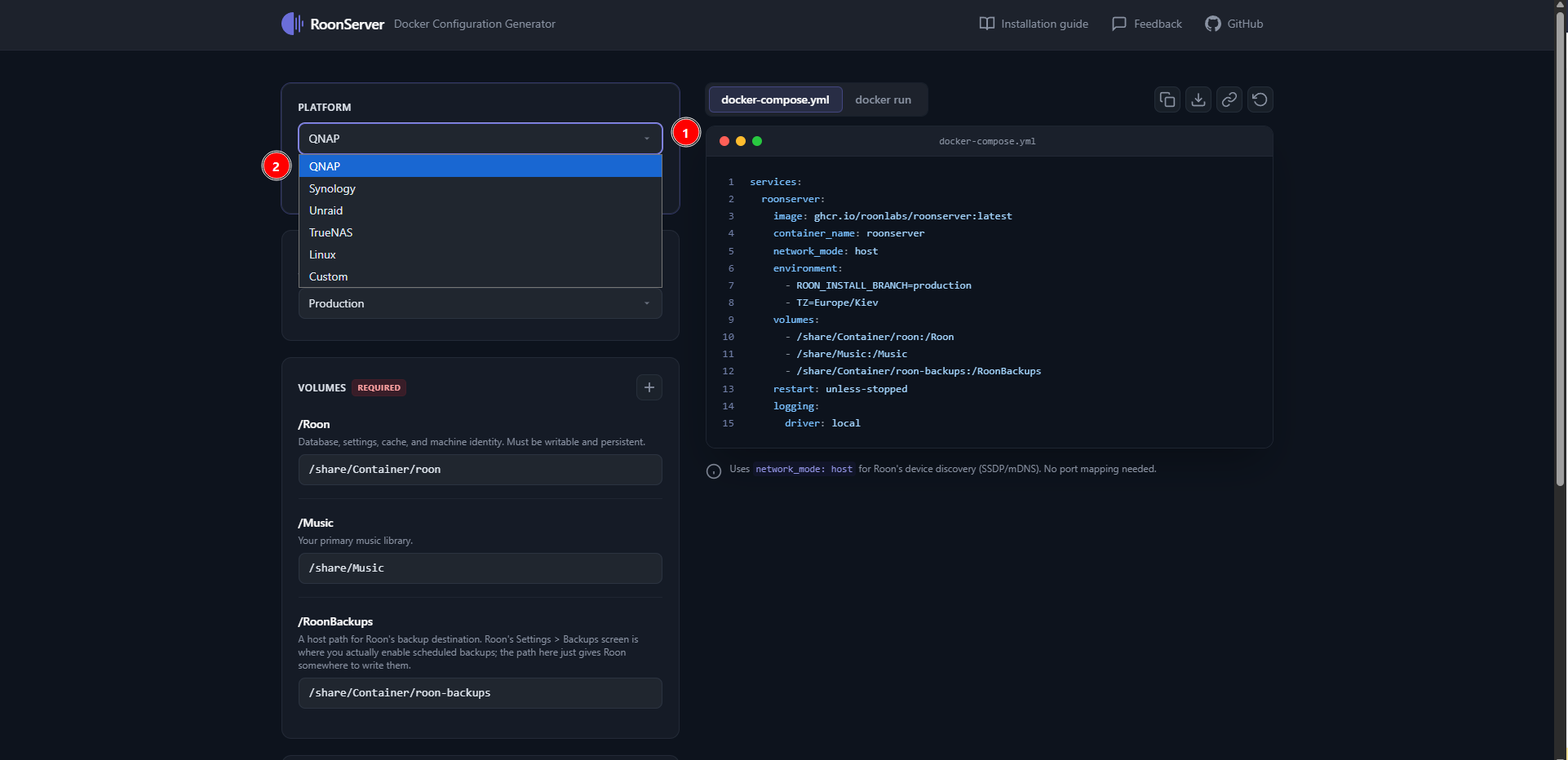

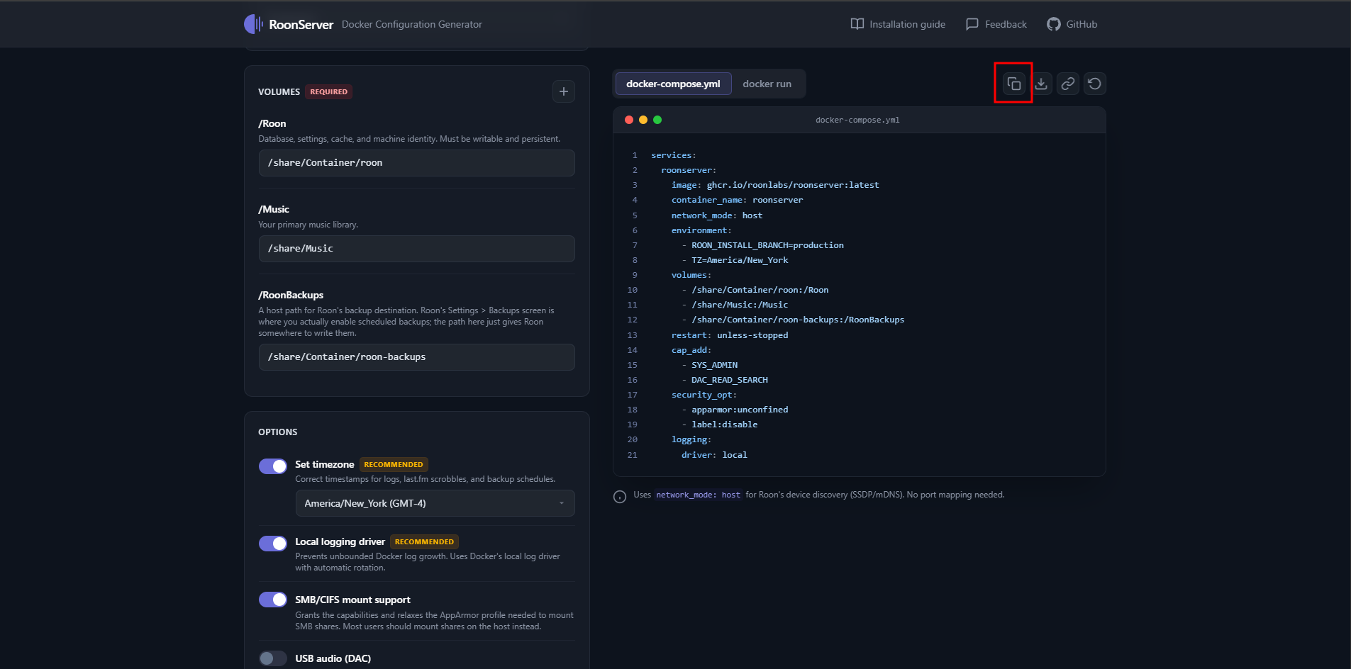

Generate the Roon Docker Configuration Generator: https://roonlabs.github.io/roon-docker/
  1. In Platform, select QNAP from the dropdown.

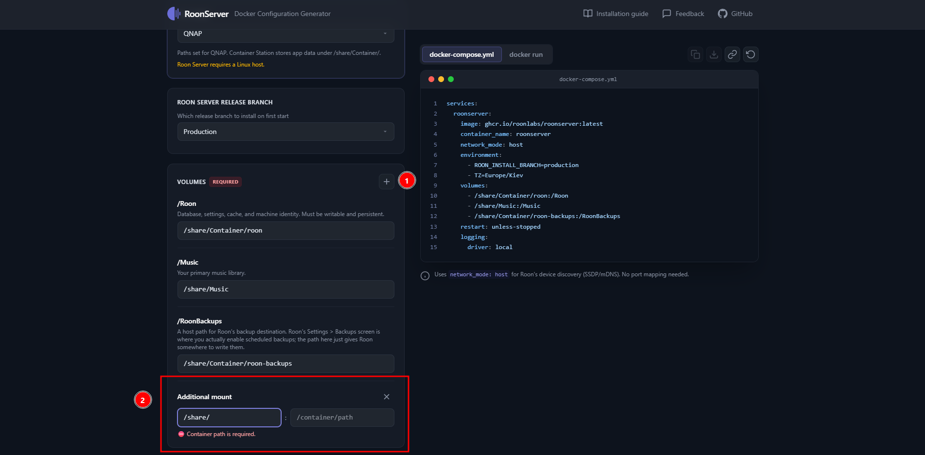

  2. In Volumes, leave the default entries as they are unless you need to add more folders.
  3. If you need to add another folder, click the + button.

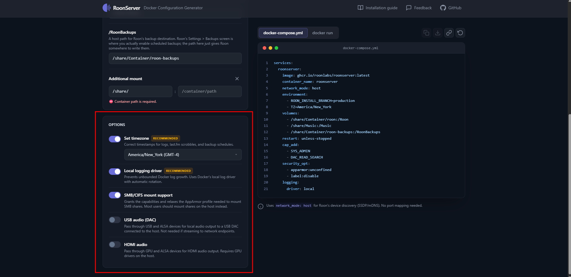

  4. In Options, select the items you need.
  5. Verify that the correct timezone was selected.
  6. Do not disable the recommended options unless you understand the impact.
  7. Click the Copy button in the upper-right corner to copy the generated Docker Compose file.

  1. Return to Container Station.

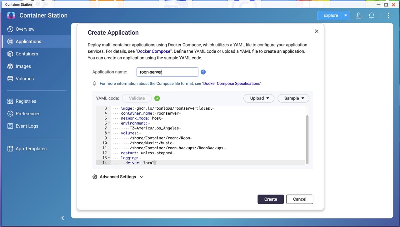

  2. In the Application name input field, replace the default value, usually app-1, with the name you want to use for this RoonServer container.
    Important for QNAP: The Application name must strictly follow Docker Compose naming conventions. It must contain only lowercase letters, numbers, hyphens (-), or underscores (_), and must begin with a lowercase letter or number. Uppercase letters, spaces, and other special characters are strictly forbidden and will prevent the container from being created.
    Recommended example: roon-server
  3. In the YAML code section, paste the Docker Compose file you copied from the generator.
  4. Click Validate.
  5. If the YAML is valid, you should see a green checkmark.
Idea
If validation fails, review the YAML and confirm that the copied content is complete.

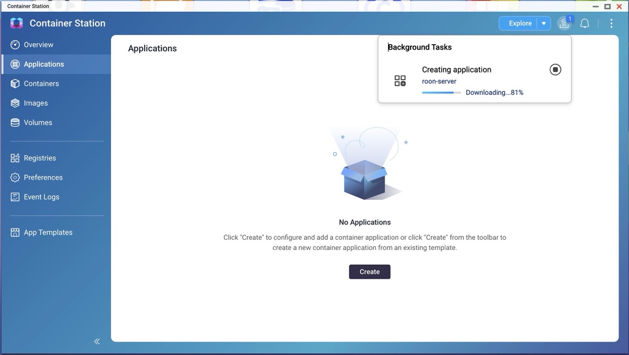

  1. Click Create at the bottom of the modal.
  2. Wait for the background task to finish.
You should see a task similar to:
When the task is complete, the RoonServer container should appear as running.

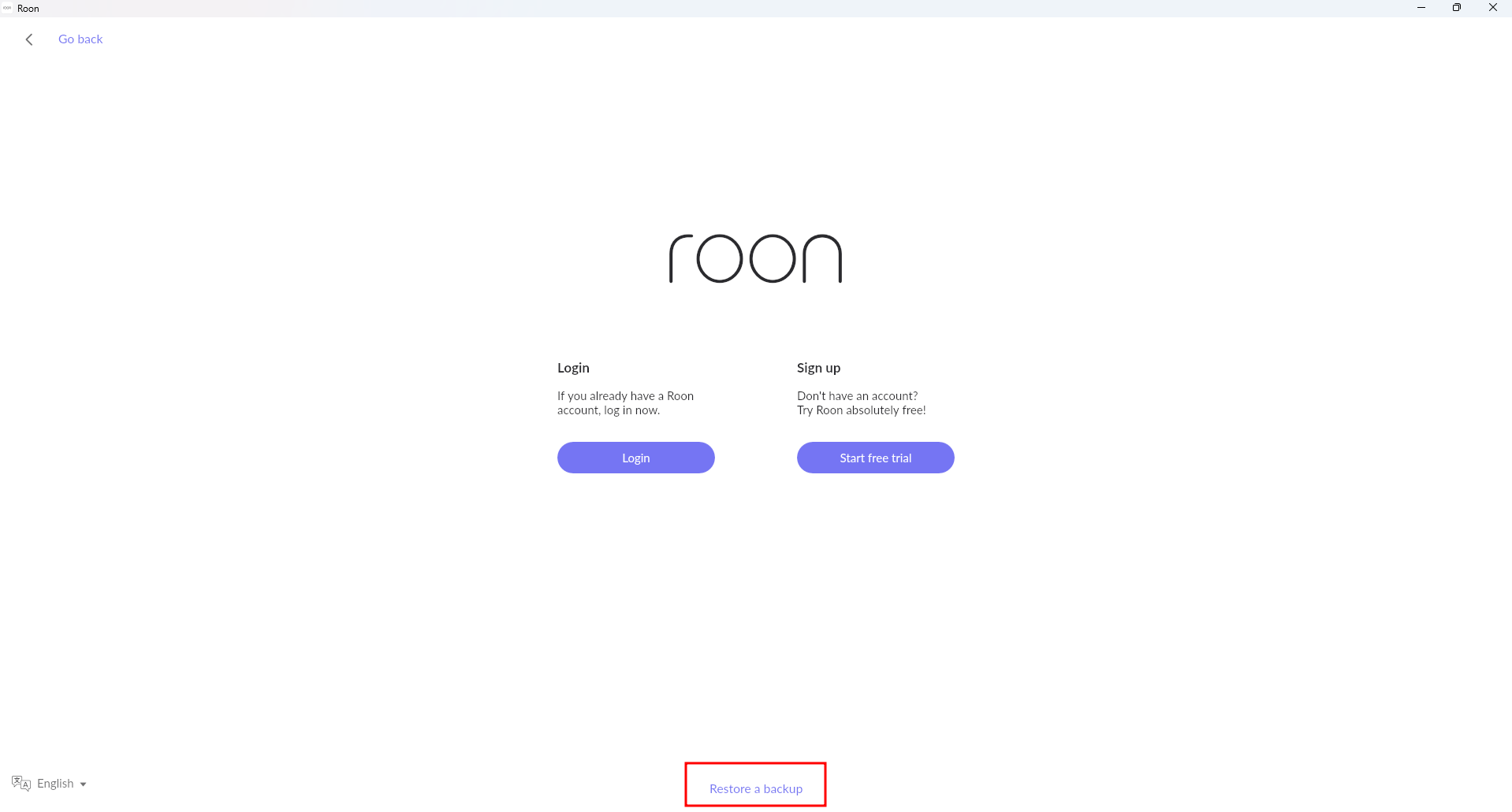

  1. On the Login screen, you can choose to restore a backup immediately or start fresh and restore your backup later from the Roon Settings -> Backup.
  2. Important Note: If you restore a backup during this step, the Roon Server will restart. If Roon brings you back to the initial setup screen after the restart, do not restore the backup again. Simply select Login and Deauthorize the old Roon Server one final time to complete the setup and access your Home screen.
Notes
Please note that the /RoonBackup folder should already contain the backup from your previous installation to restore the backup from the initial configuration screen.
