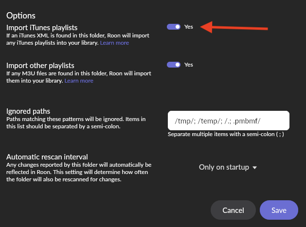

Roon imports your iTunes playlists by reading a file that iTunes can generate, called an XML. This will work as long as your XML is stored in the same folder as your media. If you've already generated the XML and configured Roon to "watch" the folder where it's stored, all you need to do is enable iTunes import. First navigate to the Edit screen for the storage location where your iTunes XML is stored:
Then, just enable iTunes Import and you're good to go!

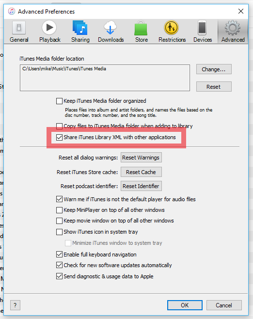

iTunes can create a file called an XML file, which contains a list of all the songs in your iTunes library, as well as all your playlists. When this file has been generated and is stored in your default Music folder, you should be able to just enable iTunes importing. Recent versions of iTunes do not create the XML file by default, so you will need to ensure the file is generated by checking this screen and making sure the Share iTunes Library XML option is checked.
