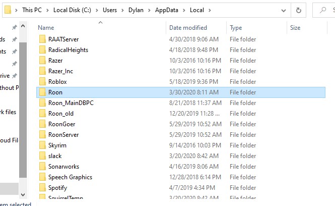

Windows Server
  1. Open Windows Explorer
  2. Click in the address area to the right of the text, to make it active like typing in a web browser, and type `%localappdata%
  3. Find and open the Roon or RoonServer folder

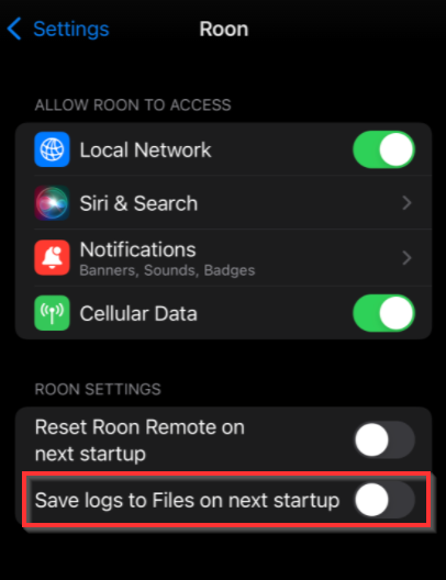

iOS Logs
1. First toggle "Save logs to Files on next startup" from your iOS Settings for the Roon App.
2. Reproduce the issue.
3. Access your Files App on the phone and upload the log file.
