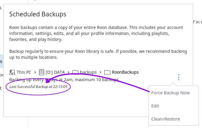

If you already have a scheduled backup
  1. Go to the Backup tab of Settings
  2. Click Scheduled Backup
  3. Click the "three dots" and select "Force Backup Now"
  4. When the backup completes you should see "Last Successful Backup" at the bottom of the Window
  5.  Shut down your Roon Server

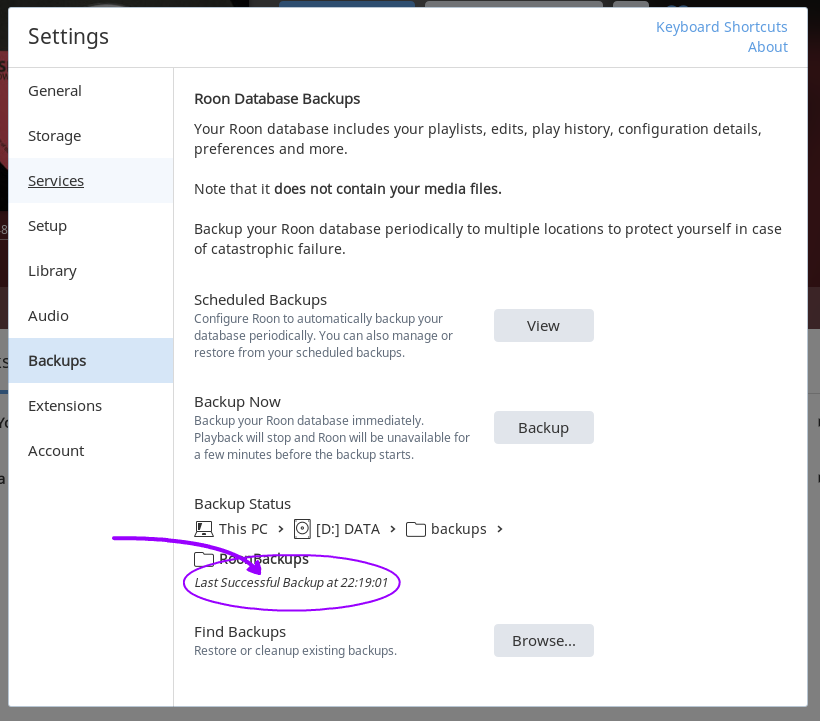

If you would like to create a new backup
  2. Click the "Backup" button next to Backup Now
  3. When the backup completes you should see "Last Successful Backup" at the bottom of the Window
  4. Shut down your Roon Server
