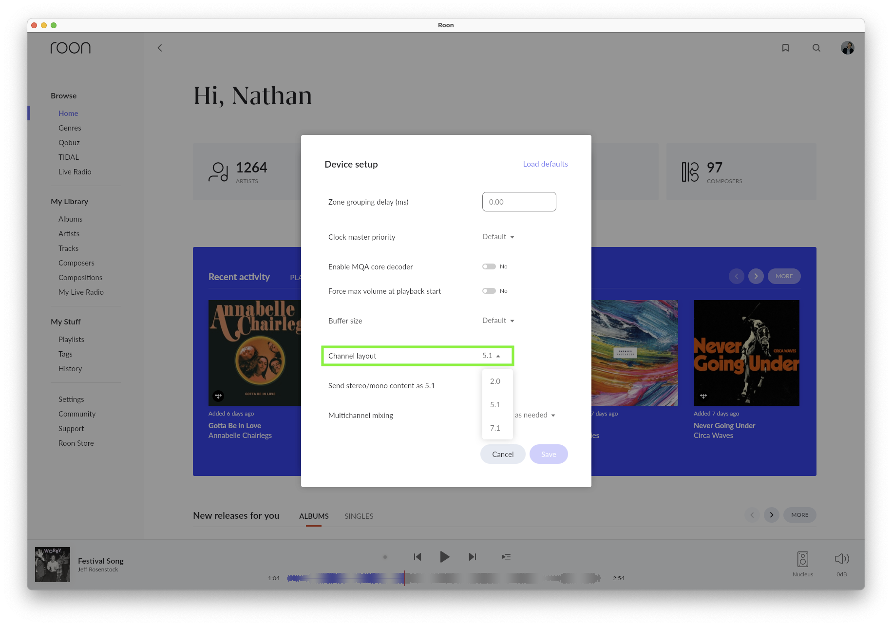

Channel Layout
If you have a multi-channel device, properly setting up your "Channel Layout" is the most important step. The following screenshots walk you through this process.

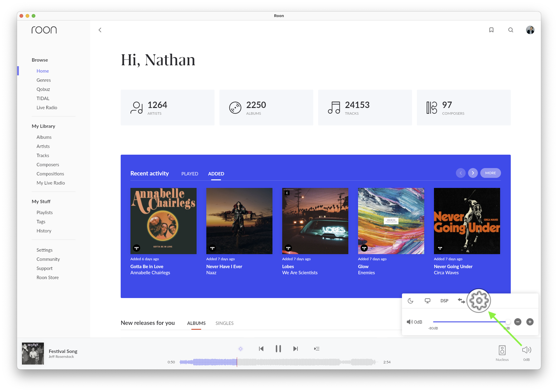

Start by clicking the speaker icon in the bottom right corner, and then the gear icon from the menu that appears

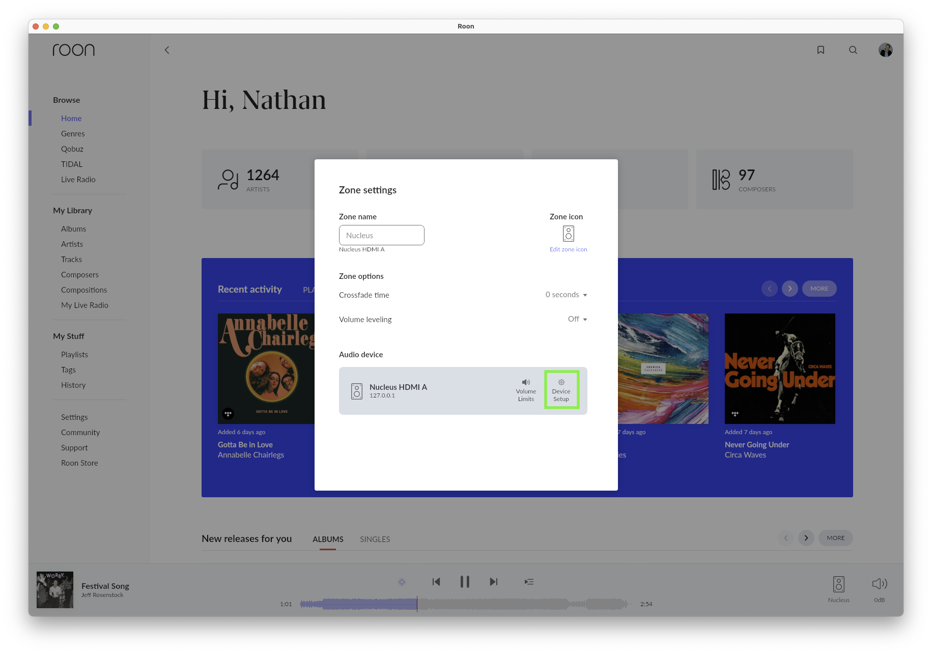

Next, you'll need to select "Device Setup" from the pop-out menu that appears
Finally, click "Show advanced" and then scroll to the bottom to find the Channel layout setting
The meaning of these layouts is:
  1. 2.0: L R
  2. 5.1: L R C LFE SL SR
  3. 7.1: L R C LFE RL RR SL SR
L = Left, R = Right, C = Center, LFE = Low Freq Effects, RL = Rear Left, RR = Rear Right, SL = Surround Left, SR = Surround Right
If you have 2 speakers, choose 2.0. If you have up to 6, choose 5.1, and if you have 8, choose 7.1. Then make sure they are wired in the right order. If you are using HDMI, you may need to use 7.1 even if you only have 6 speakers--many AV receivers don't work properly with 5.1. Roon Ready devices should present the channels in order specified above. Other devices may do other things. The best way to figure it out is to find some test tones that send audio to one channel at a time and play them back.

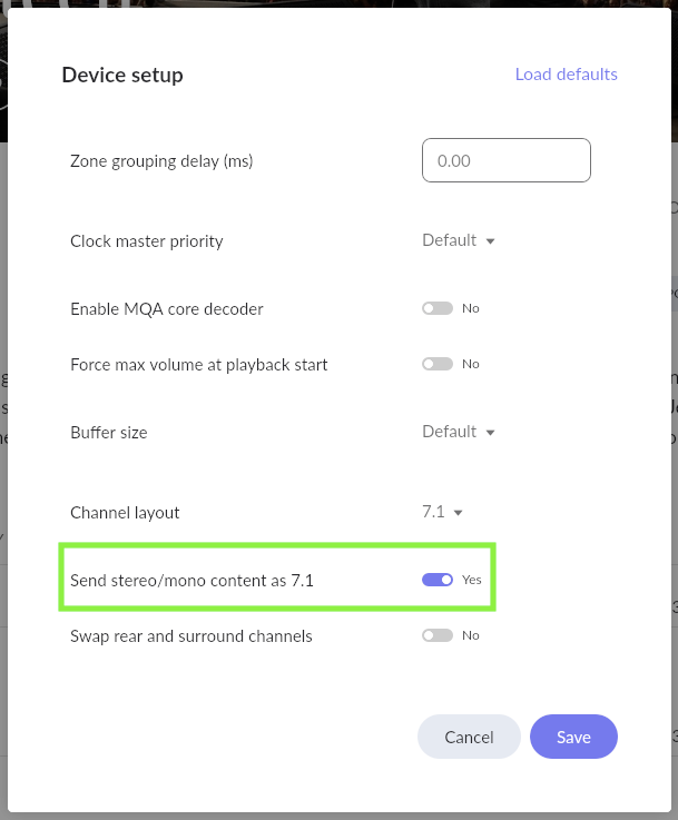

Send stereo/mono content as 7.1 or 5.1
By default, Roon sends stereo/mono content using the “2.0” layout, and only multi-channel content uses the selected layout. Toggling this setting allows users to force surround playback for stereo content if desired, but we expect that the default behavior will offer the best results for the great majority of use cases.

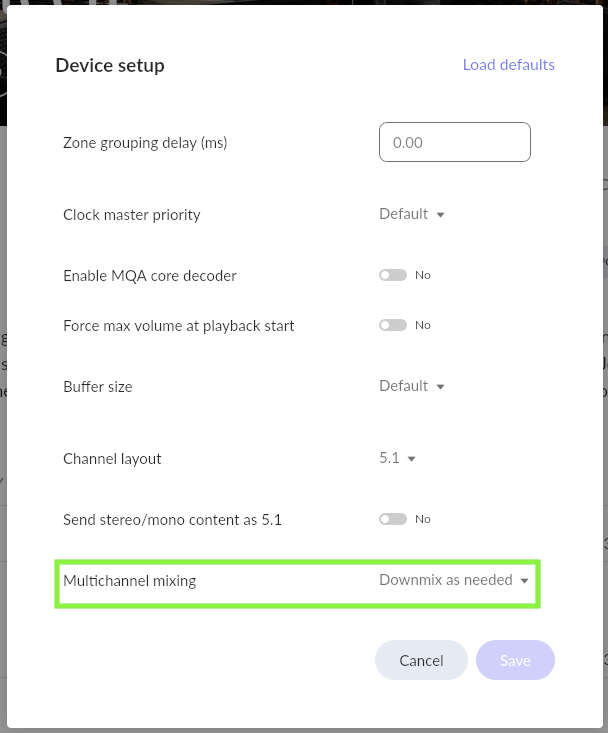

Multichannel Mixing Strategy
There are two options: "Downmix as Needed" and "Channel Mapping Only". By default, Roon is set up to Downmix content if the content has more channels than the output device--this is the setting we recommend. If you prefer that Roon not perform any downmixing, you should use "Channel Mapping Only". Roon will simply drop any channels that can't be mapped to speakers instead of playing them.
