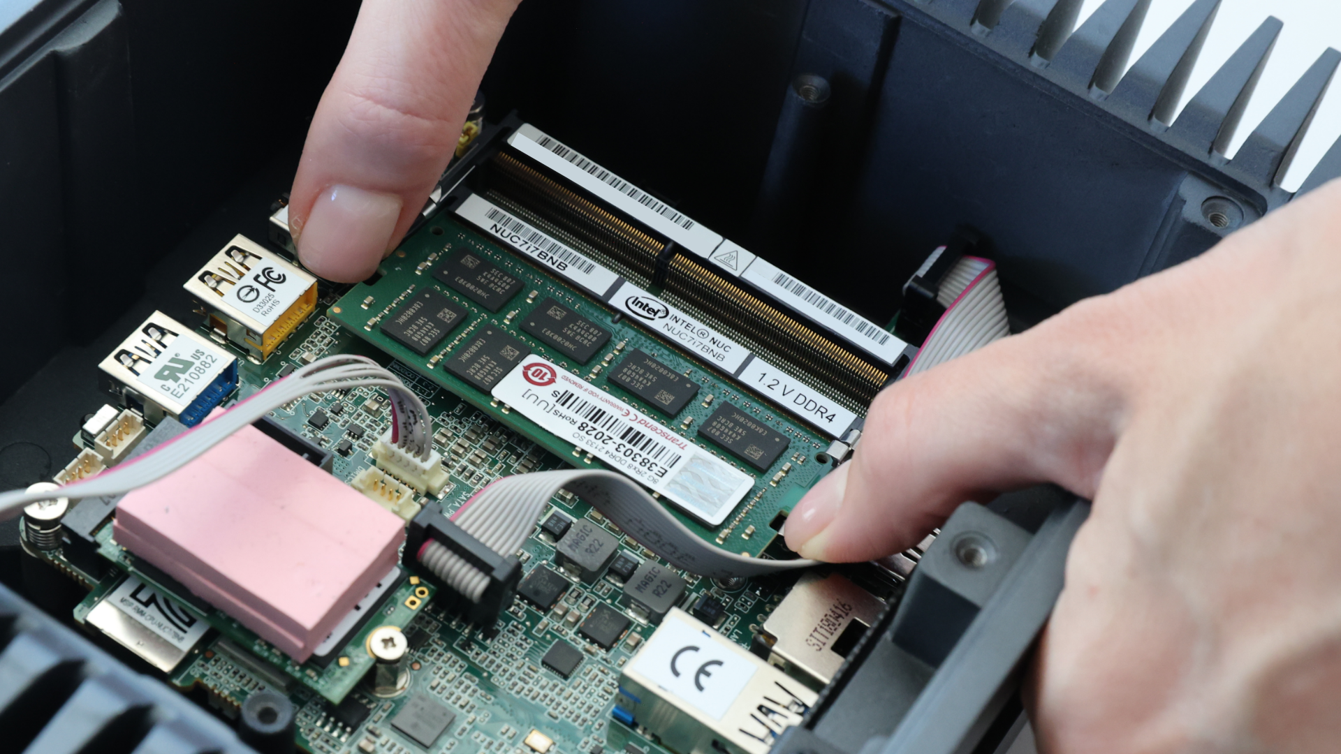

Nucleus / Nucleus Plus (Rev B) RAM Replacement Instructions

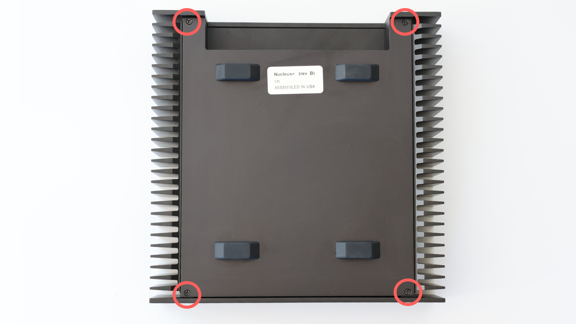

1. Remove the bottom lid (4 screws) and carefully lift the cover

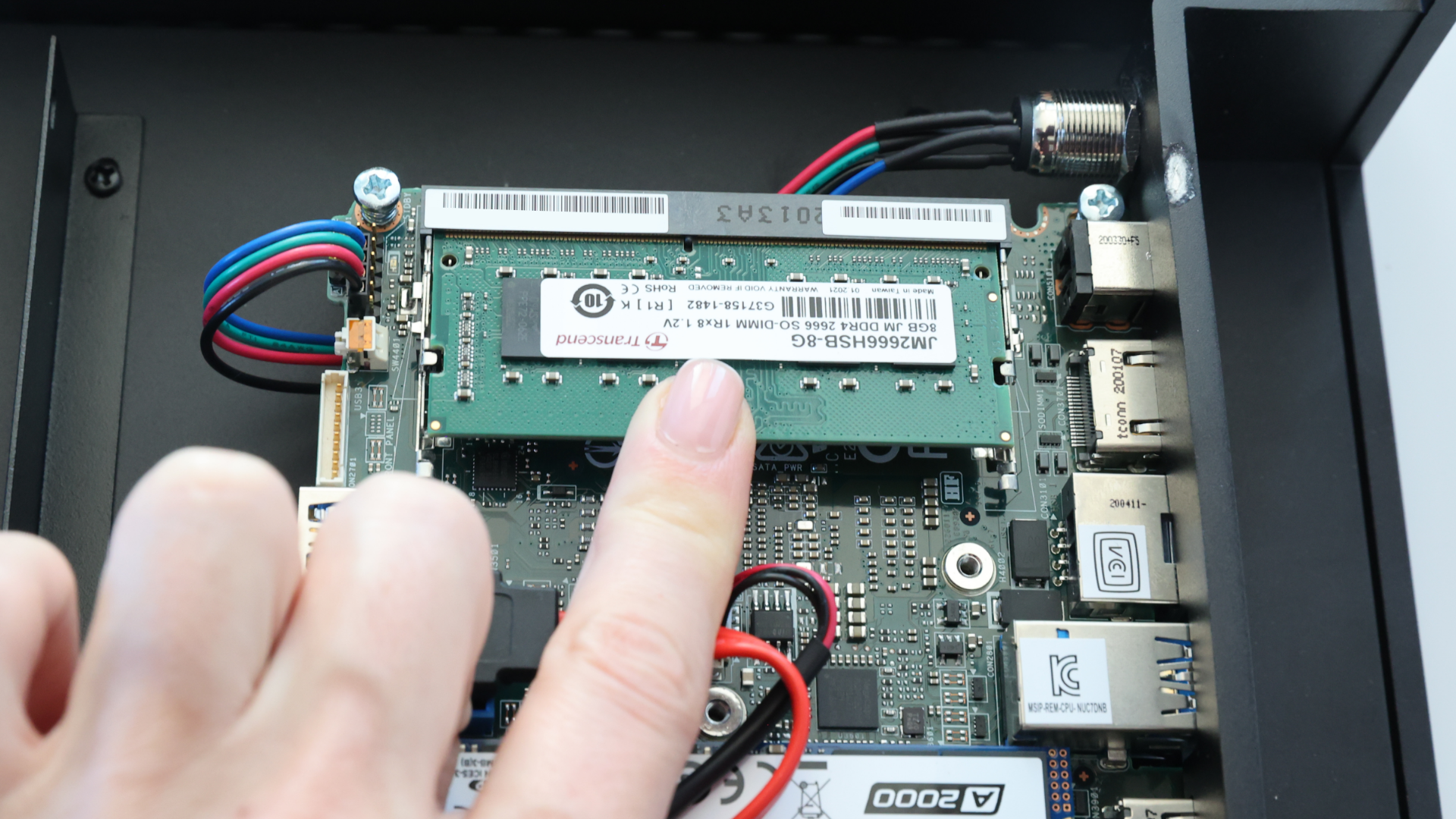

2. Locate the RAM module on the motherboard and gently push the retention clips on both sides of the RMA stick outward (away from the RAM module). Then pull the RAM out.
Reassembly:

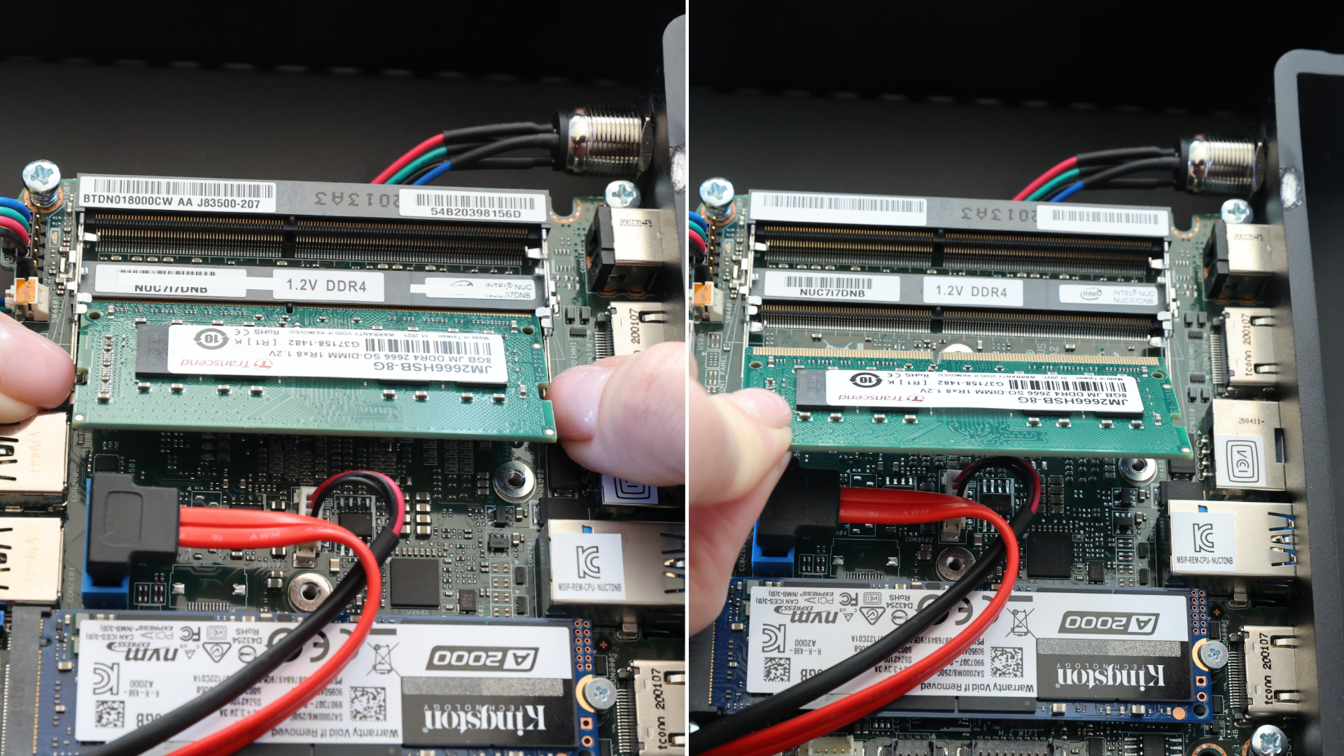

1. Align the notch on the RAM module with the slot and insert the module at a slight angle
  • For Nucleus RAM replacement, the suggested model requirements are DDR4, Form Factor = SO-DIMM with the maximum size of 16GB. There are 2 slots for RAM
  • For Nucleus Plus RAM replacement, the suggested model requirements are DDR4, Form Factor = SO-DIMM with the maximum size of 32GB. There are 2 slots for RAM
2. Press the RAM down firmly until the side clips click into place
3. Reinstall the bottom lid and secure it with the 4 screws
Nucleus / Nucleus Plus (Rev A) RAM Replacement Instructions

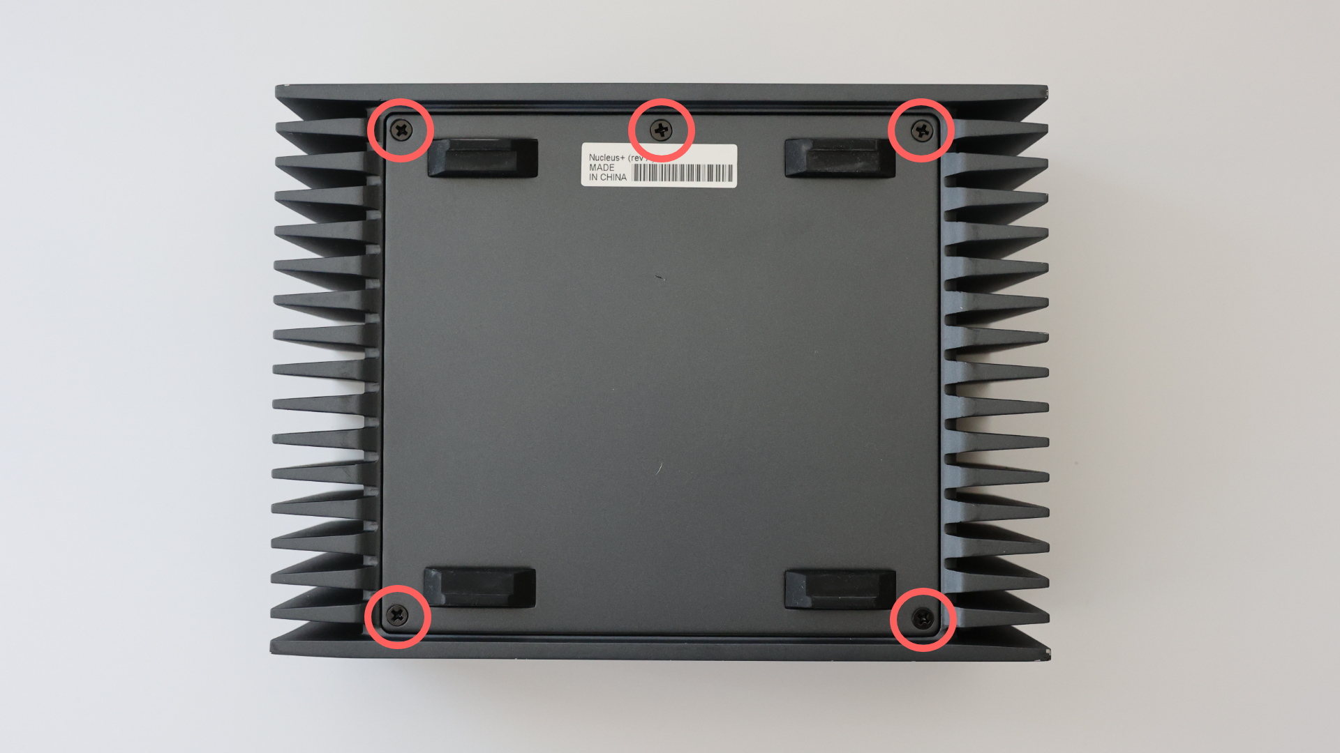

1. Remove the 5 screws to detach the bottom lid

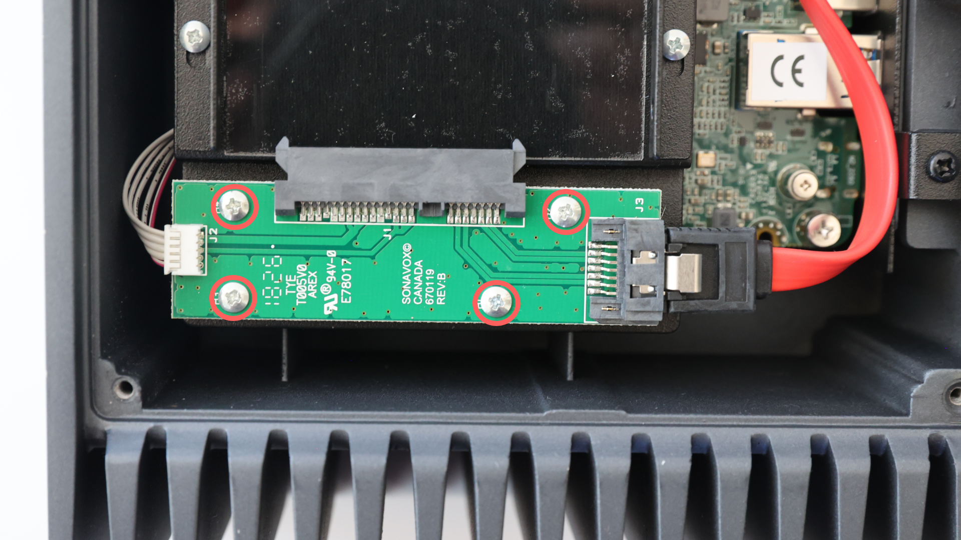

2. Unscrew the SATA connector (4 screws)

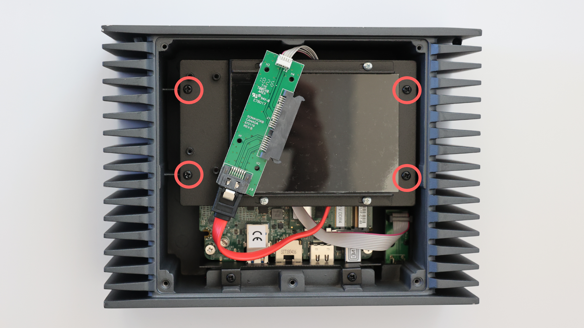

3. Unscrew the hard drive tray (4 screws) and put it a side
4. Locate the RAM module on the motherboard and gently push the retention clips on both sides of the RMA stick outward (away from the RAM module). Then pull the RAM out.
Reassembly:
3. Reattach the hard drive tray using the 4 screws
4. Reattach the SATA connector using the 4 screws
5. Reinstall the bottom lid and secure it with the 5 screws
