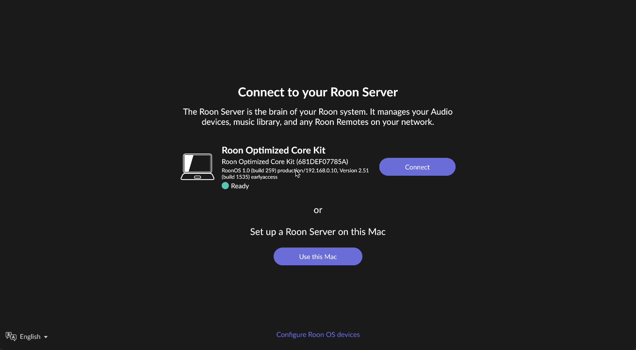

If you're restoring to a new Roon Server:
  1. Install Roon and launch it.
  2. When prompted to set up a new Roon Server, click "Restore a Backup" on the welcome screen.

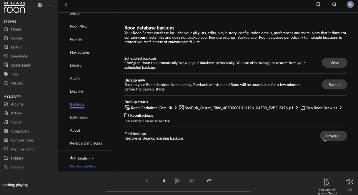

If you're restoring to an existing Roon Server:
  1. Open the Roon app.
  2. Go to Settings > Backups.
  3. Click “Find Backups”.
  4. Choose “Browse” to locate your backup folder (this is where Roon will need proper access to your Backup location).

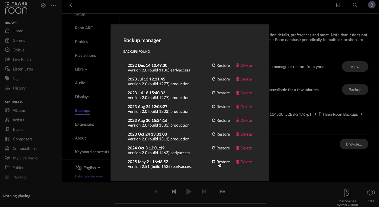

Step 3: Select the Backup Version
Once Roon reads the backup folder, it will show a list of available backup dates.
  1. Choose the version you want to restore.
  2. Click Restore.
  3. Confirm restore - click Yes
This will commence the restore process.
