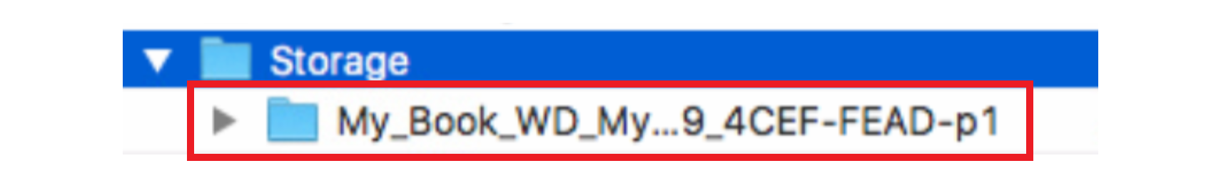

If your device has internal storage or a connected USB drive, you'll see a folder for it in the Storage folder:
The Storage folder in the Data share, showing a folder for a connected USB drive
If your Storage folder is empty, your device doesn't have any music storage connected. If you think something is wrong, please get in touch with our Technical Support team here.
