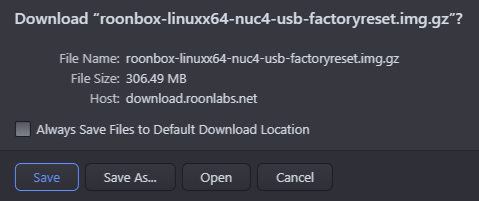

The downloaded file ends in .img.gz. You don't need to decompress or unzip it.
The downloaded RoonOS recovery image file, ending in .img.gz

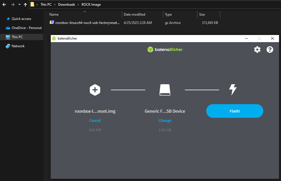

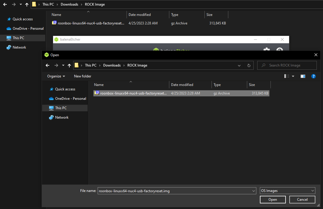

  4. Click Flash from file and select the .img.gz file you downloaded.
  5. Click Select target and choose your USB flash drive.
  6. Click Flash! and wait for it to finish.
Here's the flashing process in Etcher:
Etcher with the recovery image selected
Etcher with the USB flash drive selected as the target
Etcher flashing the image to the USB flash drive
Etcher showing that the flash is complete

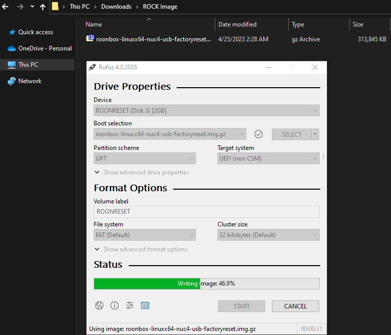

If you have trouble flashing with Etcher, you can also try Rufus on Windows. Here's the flashing process in Rufus:
Rufus with the USB flash drive and the recovery image selected
Rufus confirming that the USB flash drive will be erased
Rufus showing that writing the image is complete
