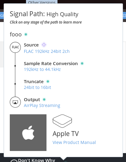

Finally, enable the device (or devices) you want to use, and play some music! Sound Quality over AirPlay only accepts CD-quality (44.1kHz/16bit) audio. Furthermore, some AirPlay devices (notably, AppleTVs) convert the audio to 48kHz/16bit internally; not a very nice thing to do. As a result, you will often see rather complex format conversions in Roon's Signal Path like this one:
AirPlay can be a very convenient and affordable solution; however audio quality is capped at 44.1kHz/16 bit. If this is a concern, a device more capable of Hi-Res playback may be desirable for the primary listening areas in your house.

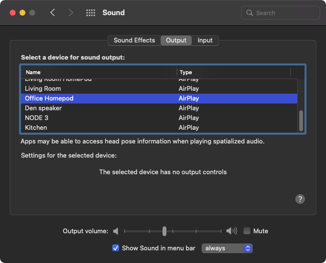

Mac
1. Make sure that the Mac's "System Output" zone is enabled in the Settings > Audio screen in Roon.
2. Open the System Preferences app on the Mac.
3. Navigate to Sound > Output and select the AirPlay 2 device in the device list.
3. Start playback to the "System Output" zone in Roon.
Screenshot of the System Preferences > Sound > Output screen:

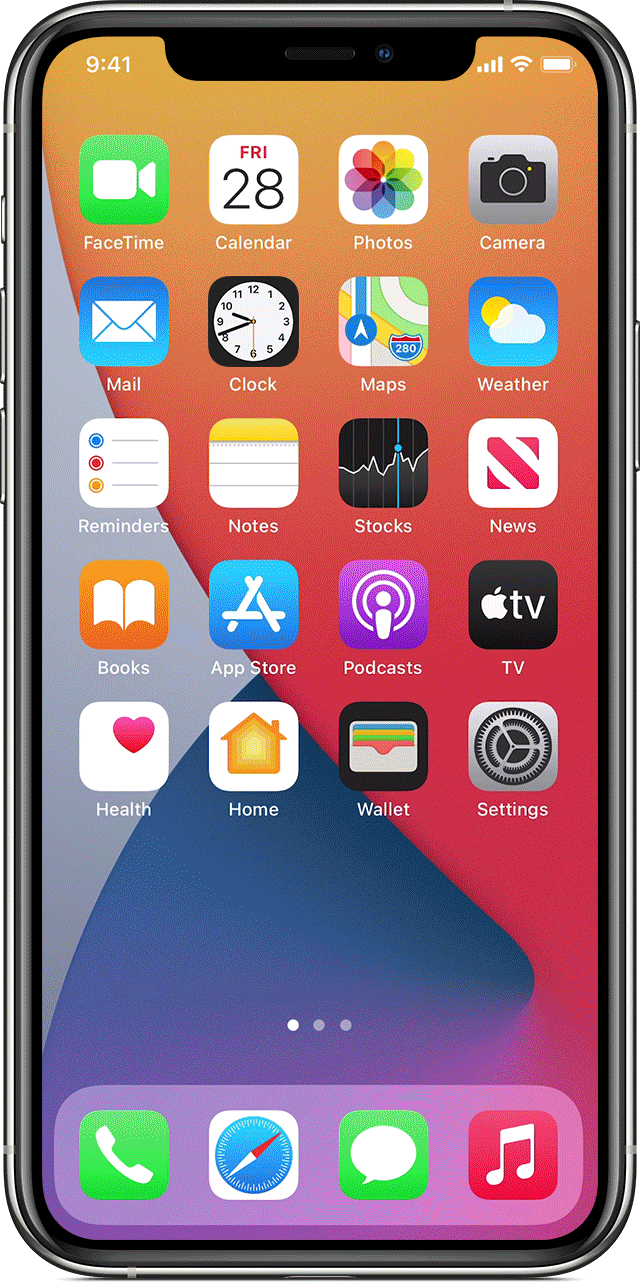

iOS
1. Make sure that the iOS device's output is enabled in the Settings > Audio screen in Roon.
2. Open Control Center on your iOS device:
      - On iPhone X or later or iPad with iPadOS or later, swipe down from the upper-right corner of the screen.
      - On iPhone 8 or earlier or iOS 12.2 or earlier, swipe up from the bottom edge of the screen.
3. Touch and hold the group of controls in the upper-right corner, then tap AirPlay .
4. Tap the speaker or TV that you want to play the audio to.
5. Start playback to the iOS device zone in Roon.
Animation showing how to open control center and select an AirPlay output:

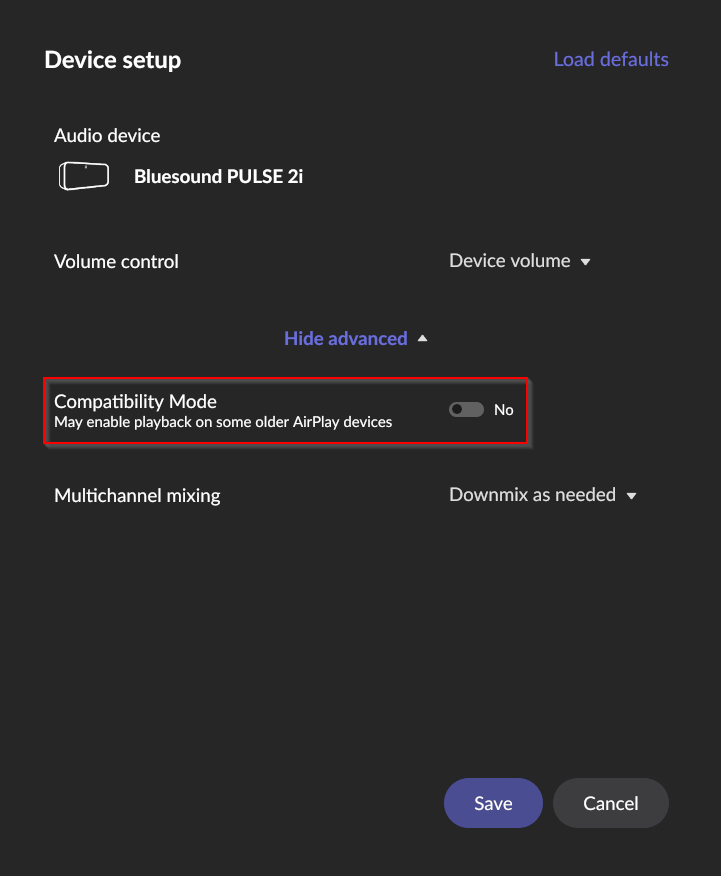

Airplay Compatibility Mode
If you're using an older Airplay device and are having issues selecting it as an endpoint, try toggling on Compatibility mode. You can access the toggle by accessing the Advanced settings found in Device setup:
  1. Click the Volume icon in the lower right corner
  2. Click the cogwheel icon
  3. Click Device Setup
  4. Expand Advanced Settings
If you're still having issues, please reach out to Roon Support via our Community here.
