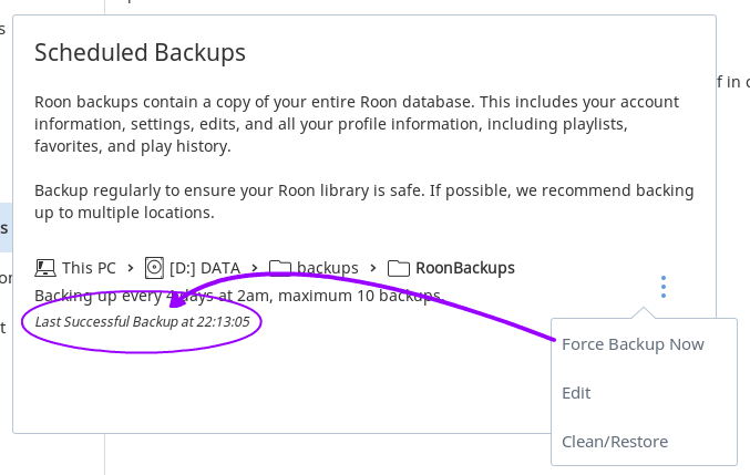

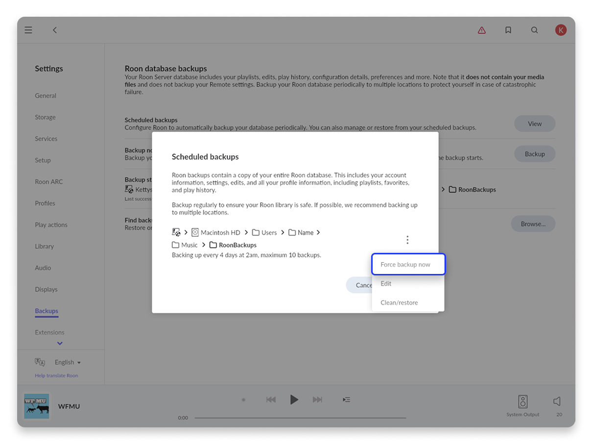

  1. If you've already scheduled Roon to backup to local or network storage, go to the Backup tab of Settings
  2. Click Scheduled Backup
  3. Click the "three dots" and select "Force Backup Now"
  4. When the backup completes you should see "Last Successful Backup" at the bottom of the Window
  5. Shut down your Roon Server

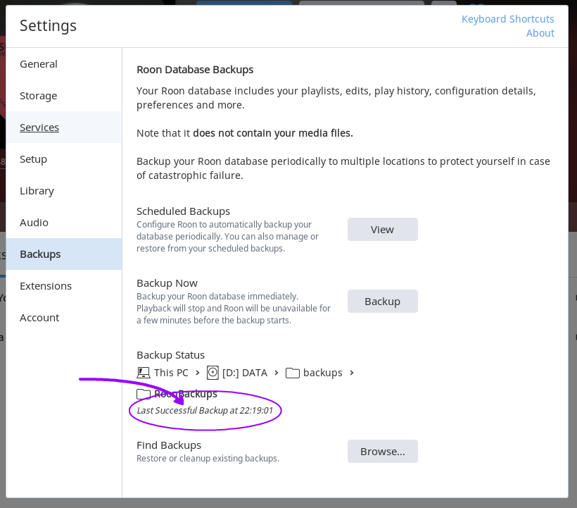

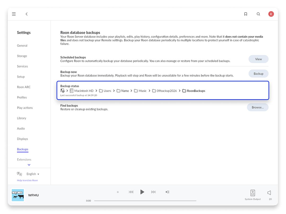

  1. Go to the Backup tab of Settings
  2. Click the "Backup" button next to Backup Now
  3. When the backup completes you should see "Last Successful Backup" at the bottom of the Window
  4. Shut down your Roon Server

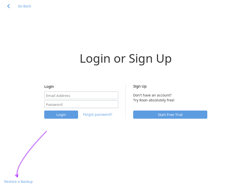

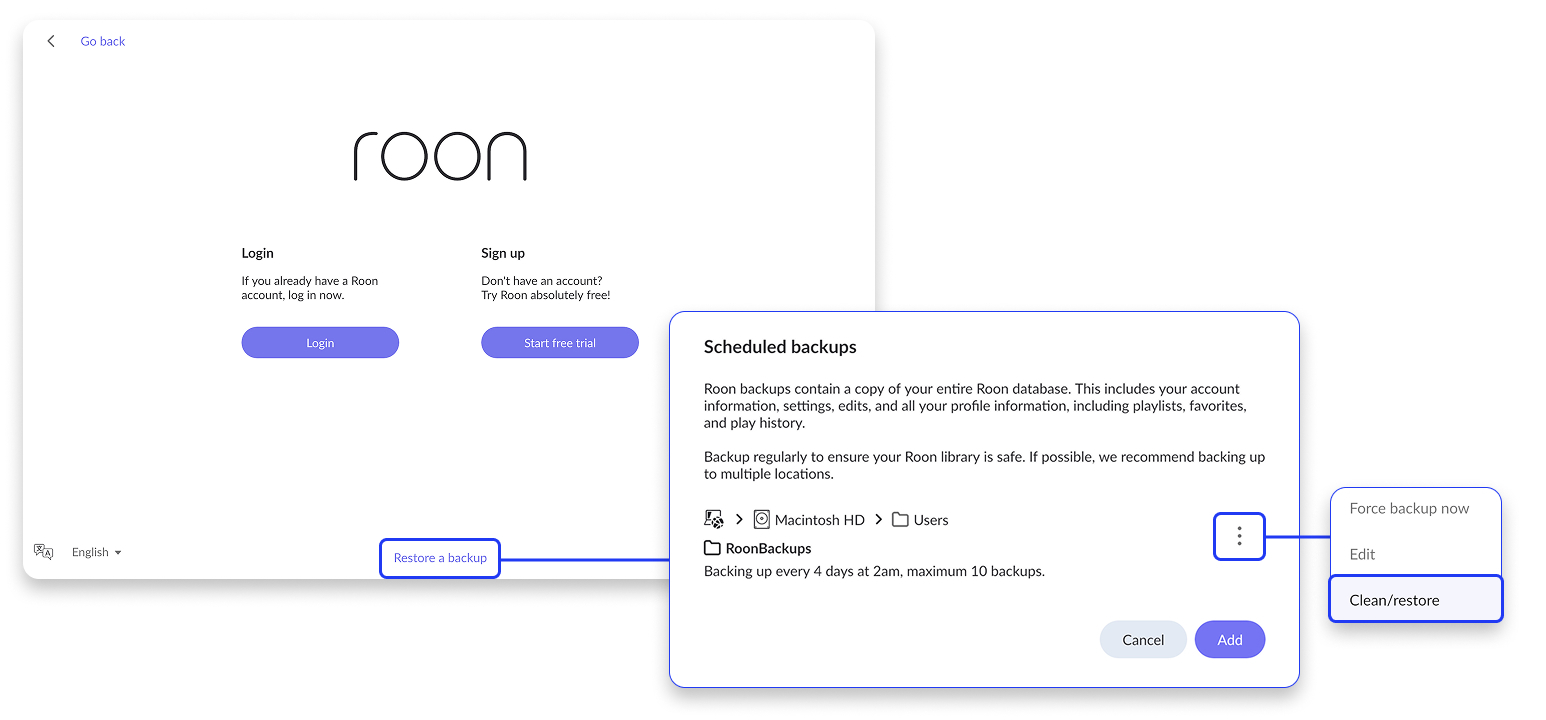

  1. Since this is your first time launching Nucleus, you will be asked to log-in when you connect. Instead of logging in, click "Restore A Backup" in the lower part of the screen. You will be able to log in after choosing "Restore a Backup".
  1. Use Roon's file browser to locate the `/RoonBackups` folder you created in Step 1
    1. If you created a USB backup, it should be connected to your Nucleus and you can navigate to it
    2. If you backed up to network storage, you can find the RoonBackups folder by clicking Add Network Share and entering the details for your NAS
