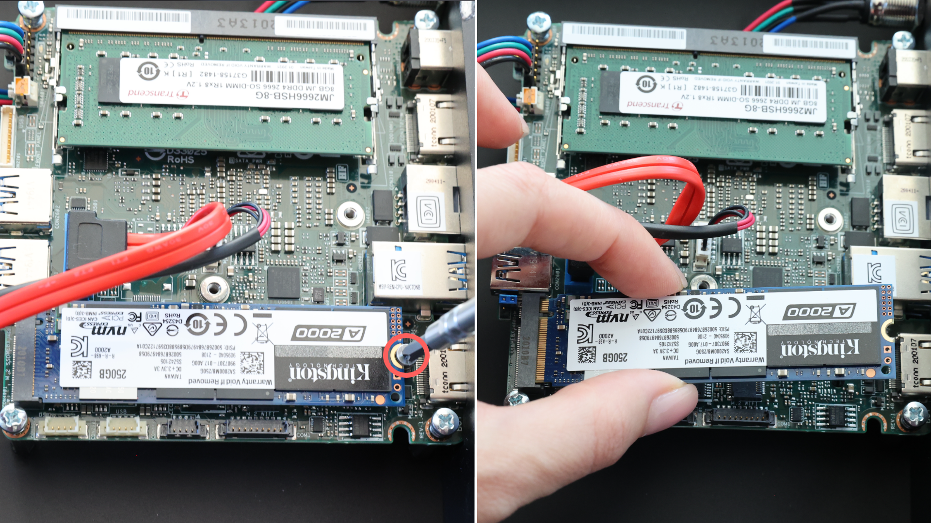

Nucleus / Nucleus Plus (Rev B) SSD Replacement Instructions
1. Remove the bottom lid (4 screws)
2. Unscrew the SSD and remove the SSD from the M.2 slot
Reassembly and ROCK installation:
1. Insert the new SSD into the M.2 slot and secure it with the screw.
2. Reattach the bottom lid using the 4 screws.

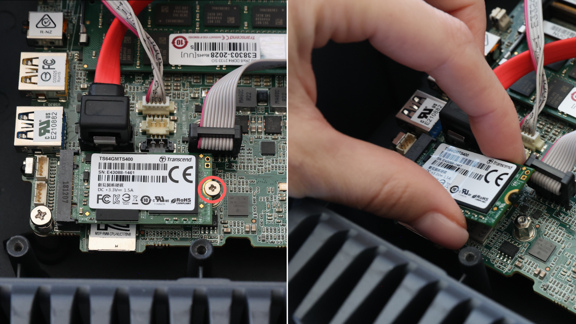

Nucleus / Nucleus Plus (Rev A) SSD Replacement Instructions
1. Remove the 5 screws to detach the bottom lid
2. Unscrew the SATA connector (4 screws)
3. Unscrew the hard drive tray (4 screws)

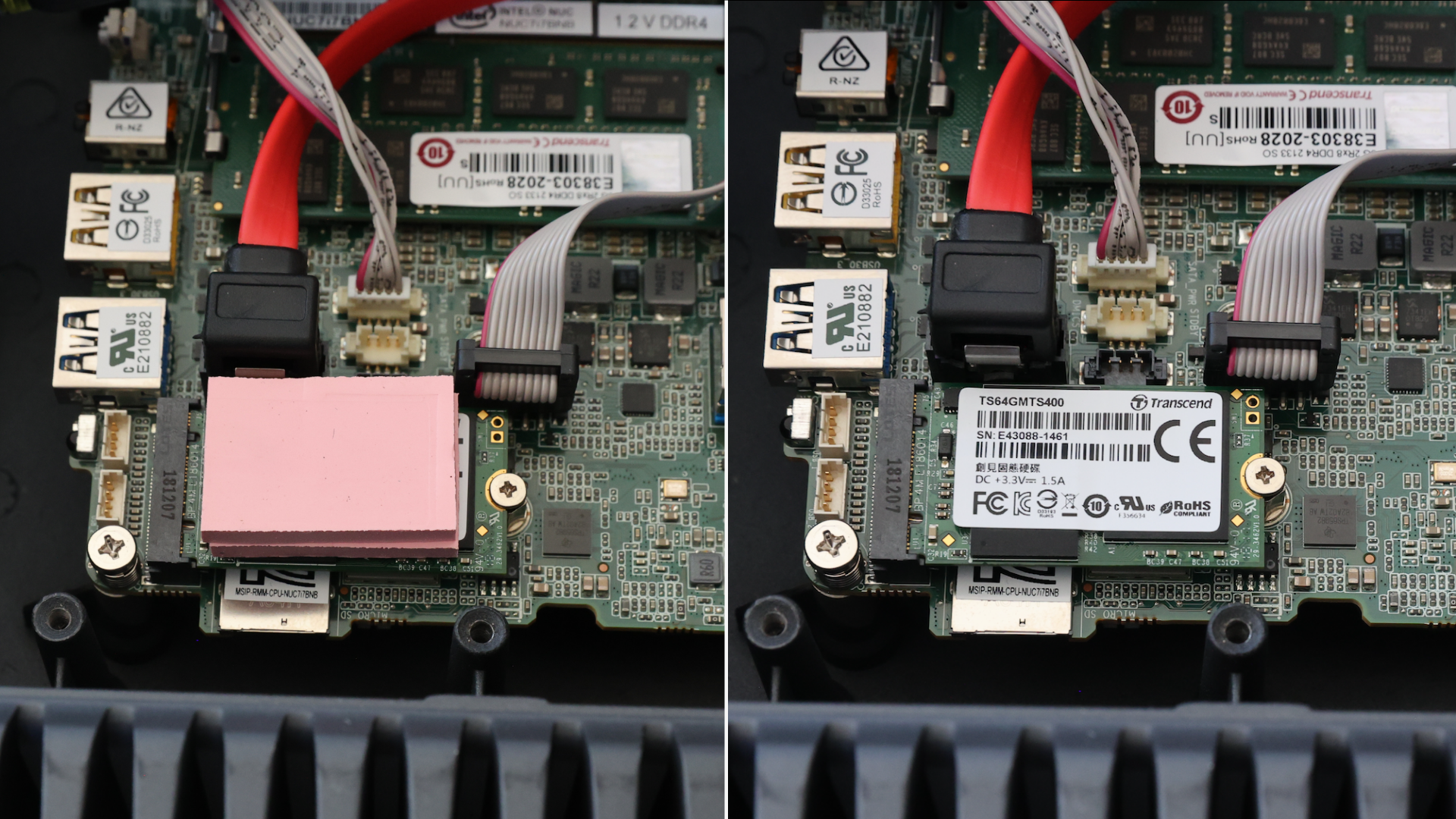

4. Locate the SSD and carefully remove the heating pads on top of it; set them aside
5. Unscrew the SSD and remove it from the M.2 slot
  • Insert the new SSD into the M.2 slot and secure it with the screw. For Nucleus or Nucleus Plus SSD replacement, the suggested model is Transcend GMTS430S 128GB M.2  (the smallest size of 128GB is all you need)
  • Reapply the heating pads in their original position
