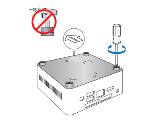

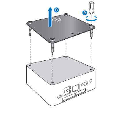

  2. Open the NUC case: unscrew the four corner screws on the bottom of the chassis and lift off the cover.
    The bottom of a NUC chassis with the four corner screws that hold the cover in place

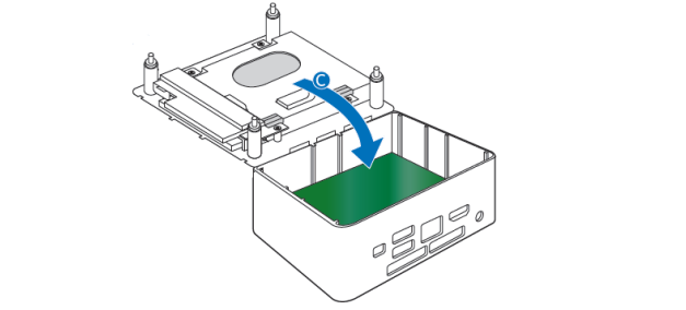

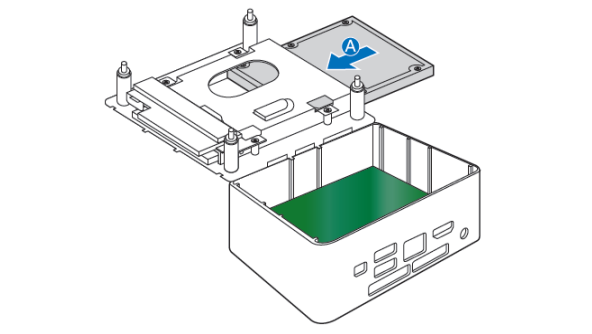

  5. Install the 2.5" drive (optional): if you're adding a music drive, it goes in the drive bay, usually on the NUC's cover.
    Sliding a 2.5 inch drive into the NUC's drive bay so it seats in the SATA connector
    1. Unscrew the four screws holding the drive bay bracket.
    2. If a drive is already installed, remove it from the drive bay.
    3. Slide the new 2.5" drive into the drive bay. Make sure its connectors are fully seated in the SATA daughter card (A).
    4. Secure the drive with the four screws from step a, then set the drive bay bracket down inside the chassis (C).
    Securing the 2.5 inch drive in the drive bay with four screws and placing the bracket inside the chassis

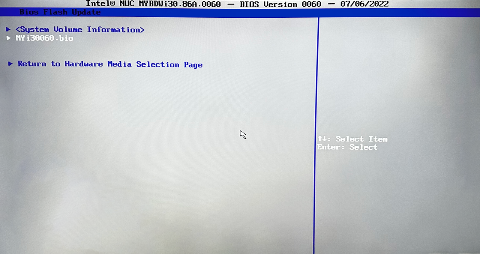

  1. Update using the F7 Flash Tool:
    1. Plug the USB drive with the .BIO file into your NUC.
    2. Power on (or restart) the NUC and press F7 when prompted during boot. The BIOS flash tool opens.
    3. In the file browser, select the USB drive, then select the .BIO file.
    4. Confirm the update. The update begins.

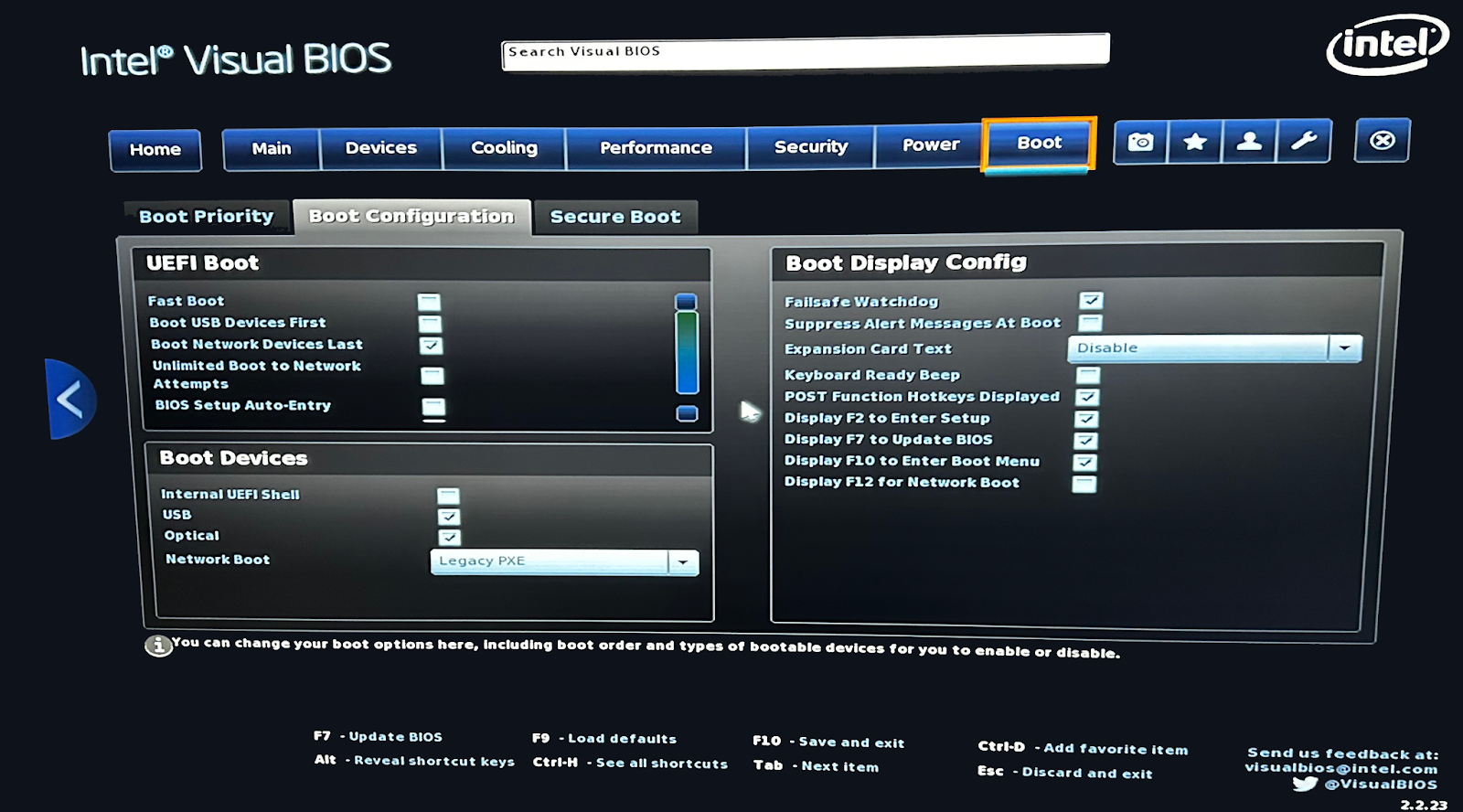

2.1. What You'll Configure in the BIOS
  • Boot mode set to UEFI: UEFI is required for RoonOS 3.0, including the redesigned Web Administration Interface and Tailscale for Roon ARC. Please disable legacy boot.
  • Secure Boot disabled: ROCK won't boot with Secure Boot turned on.
  • Boot order: your M.2 SSD should be the first boot device. USB boot should stay enabled, so you can start the installer from the boot menu.
  • Drive settings: make sure your M.2 SSD and any other drives are enabled. On some older NUCs, you need to enable the M.2 slot.
  • Power on after power loss: this setting is important for a server. It turns your NUC back on automatically when power returns after an outage.
2.2. How to Configure the BIOS
Power on your NUC and immediately press F2 to enter BIOS setup. Then, please follow Configure your NUC's BIOS. You'll also find a video of the BIOS setup at the start of 5. Installing.
Menus vary by NUC generation, so the layout may not match the guide exactly. If it doesn't, please look for settings with similar names. Once your BIOS is configured, please continue to the next section.

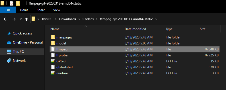

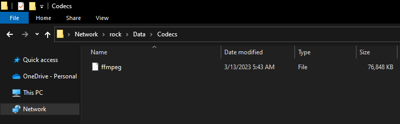

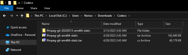

ROCK in legacy BIOS mode (RoonOS 2.x): ROCK needs codecs for some file formats, such as MP3 and AAC. Please follow Roon OS Missing Codecs to add them. You'll copy the codecs file to ROCK's Data network share. For help opening it, please see Accessing RoonOS's Data Directory.

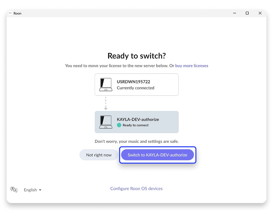

7. Connecting to ROCK from Roon

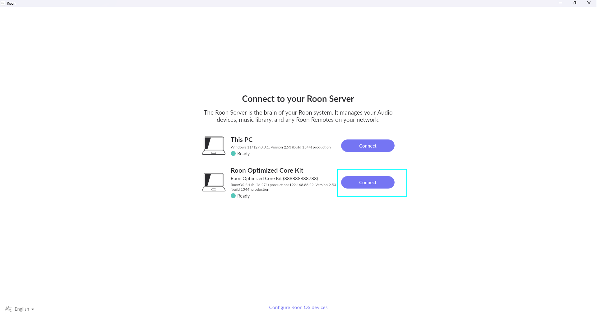

  1. Open Roon on your computer, phone, or tablet.
  2. On the Connect to your Roon Server screen, find Roon Optimized Core Kit.
  3. Click Connect.
Roon's Connect to your Roon Server screen listing a Roon Optimized Core Kit with a Connect button

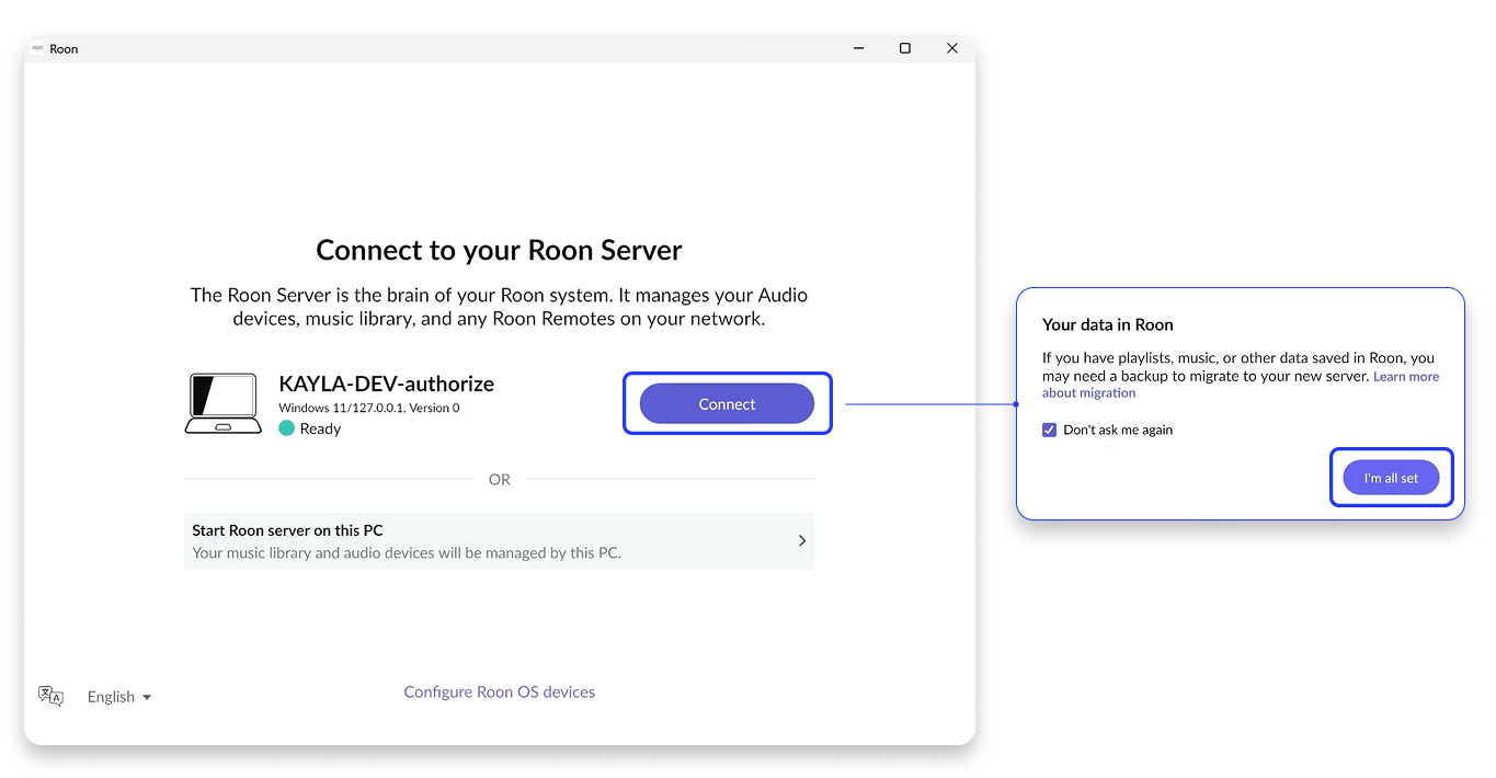

If you already use Roon with a different Roon Server, select the new Roon Optimized Core Kit from the list and click Switch.
Roon's list of Roon Servers with a Roon Optimized Core Kit selected and the Switch button

If you've used Roon with another Roon Server, you can bring your library, playlists, and settings over to ROCK. Please see Migrating To ROCK.

Roon can't find your ROCK
  • Check the Web Administration Interface: please open the RoonOS Web Administration Interface and check whether it reports missing codecs.
  • Check your network: make sure the Ethernet cable is plugged into your NUC and your router assigns addresses with DHCP. Roon also needs to run on the same network as your ROCK.
  • Test the connection (RoonOS 3.0): on the Network & Access tab, click Test connection under Network Diagnostics. It checks every layer of your ROCK's network connection.
To see what other ROCK owners are saying, please visit the ROCK category on our Community Site.
If you still can't install or connect to ROCK after these steps, please get in touch with our Technical Support team here. Please include your NUC model and a photo of any error on its screen.
