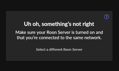

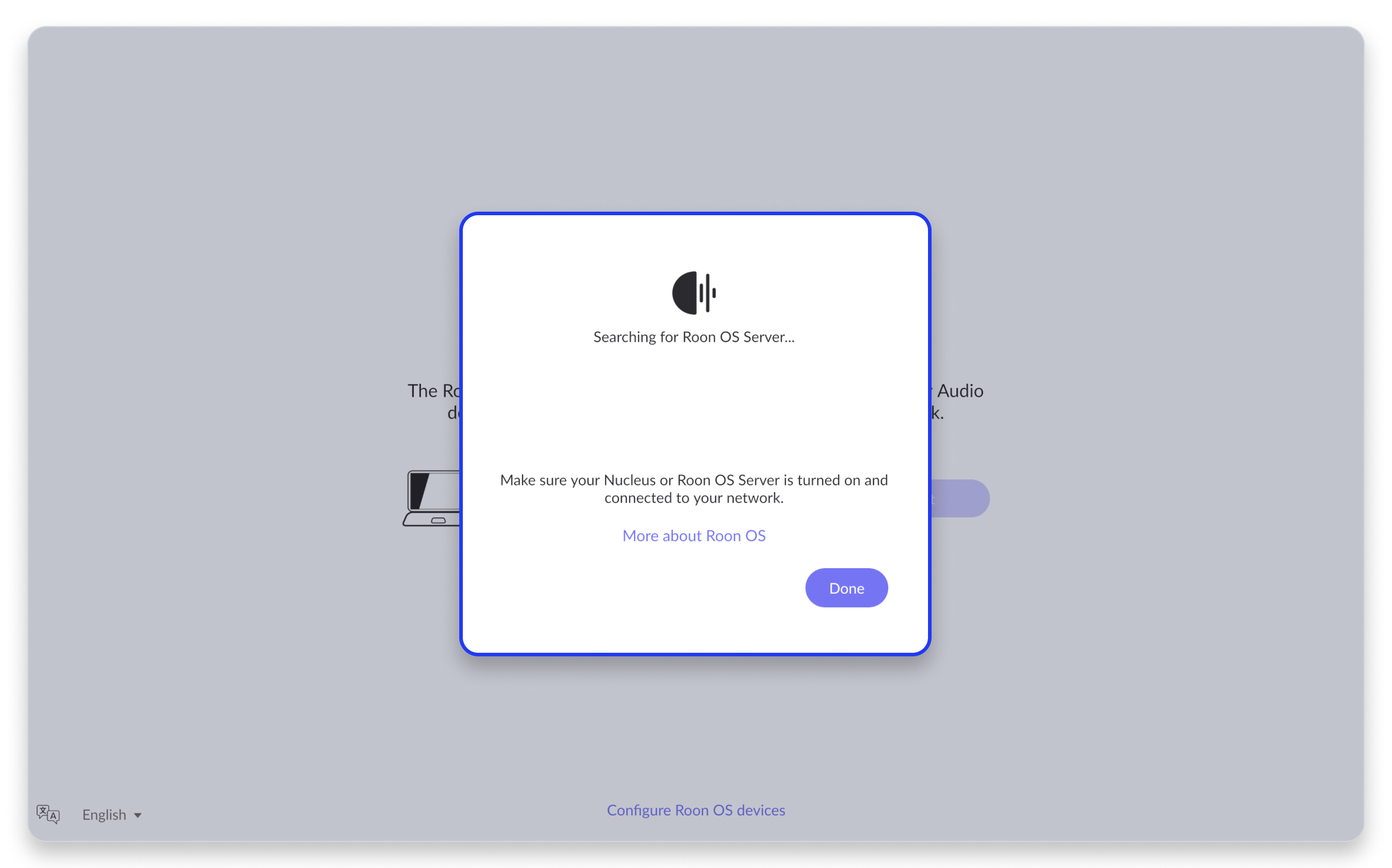

You open Roon on a phone, tablet, or computer and it can't reach your Roon Server. You may see "Uh oh, something's not right," a screen stuck on "Looking for your Roon Server," or a remote that connects sometimes and drops at other times. This article walks through the most common causes, starting with the quickest checks.
