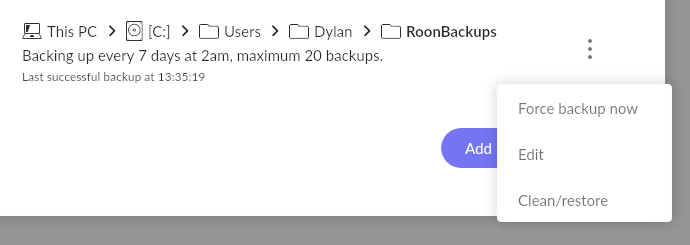

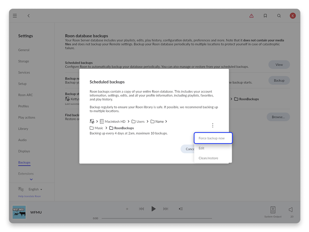

If you already have a scheduled backup:
  1. Go to the "`Backup`" tab of Settings
  2. Click "`Scheduled Backups`"
  3. Click the "three dots" and select "`Force Backup Now`"

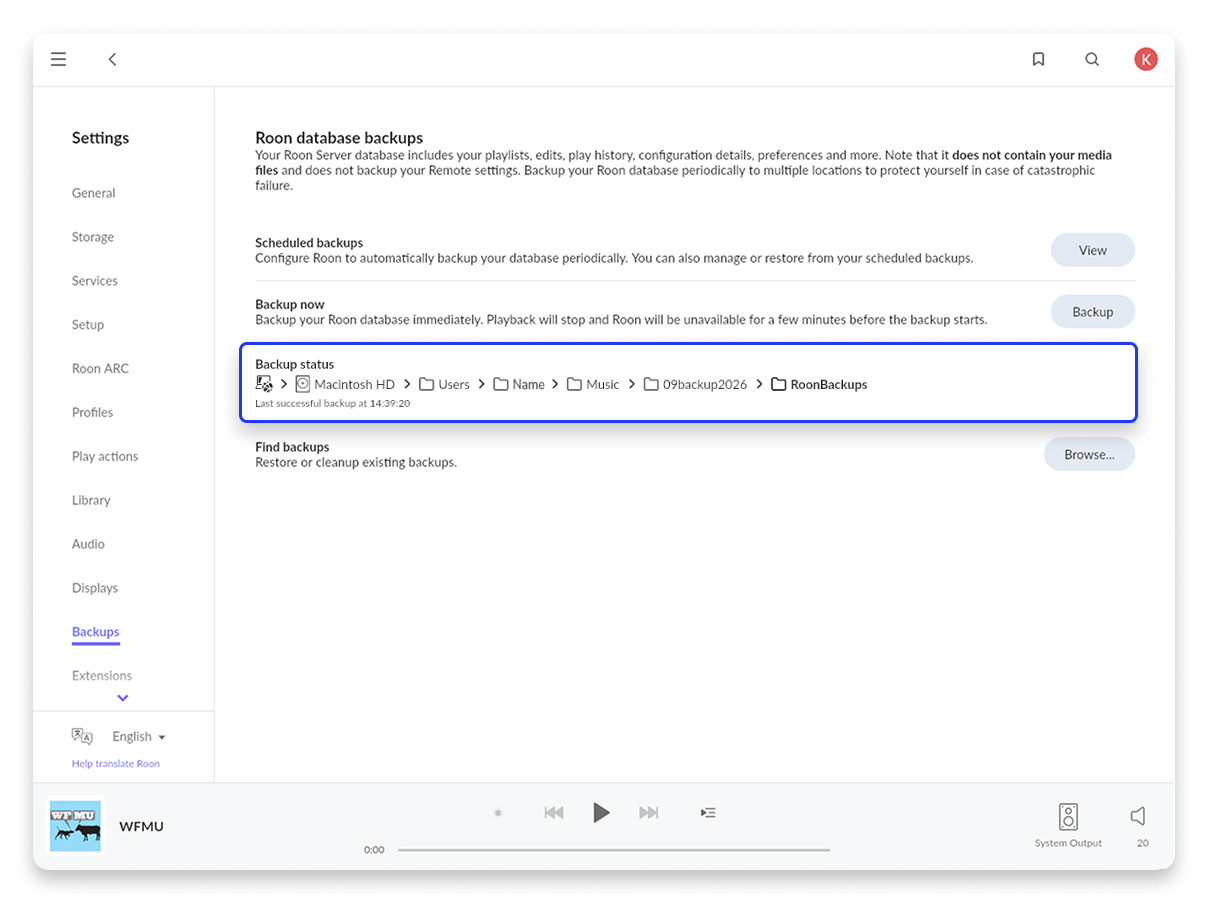

  4. When the backup completes you should see "Last Successful Backup" at the bottom of the Window
If you would like to create a new backup
  2. Click the "`Backup`" button next to Backup Now
  3. When the backup completes you should see "Last Successful Backup" at the bottom of the Window

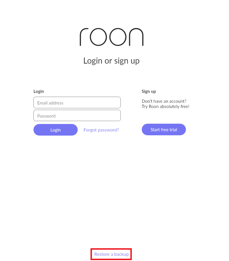

  1. Since this is your first time launching your new Roon Server, you will be asked to log-in. Instead of logging in, click "Restore A Backup" in the lower-left hand corner. You will be prompted to log in after selecting "Restore a Backup".
