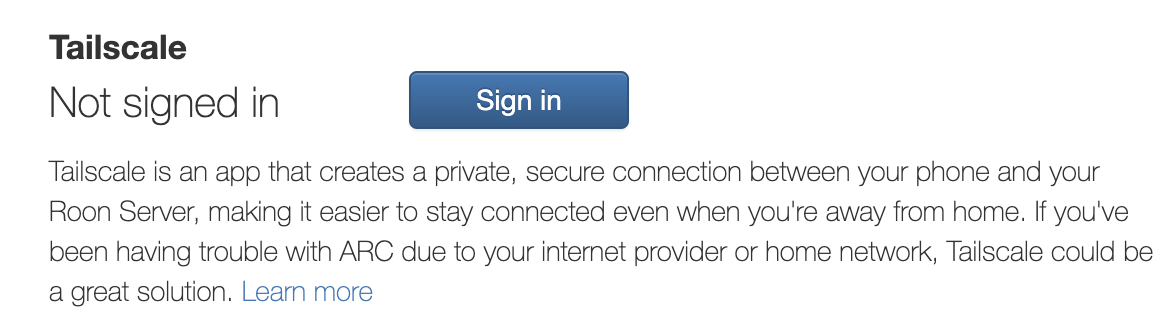

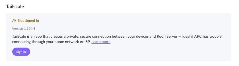

  2. Click the Network & Access tab. The Tailscale section shows Not signed in, along with the installed Tailscale version. If a newer version is available, you'll also see an Update button.
  3. Click Sign in.
The Tailscale section on the Network and Access tab, showing Not signed in with the Sign in button

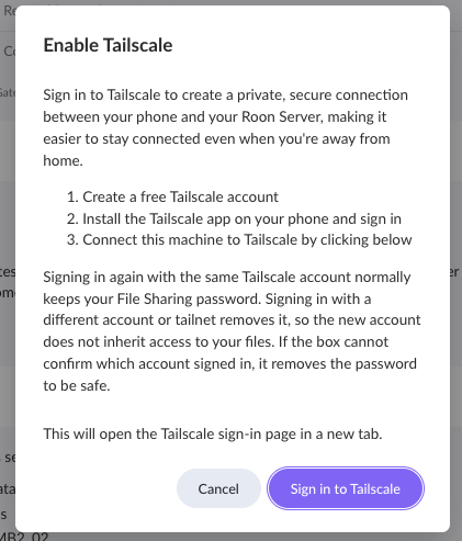

  1. In the Enable Tailscale window, click Sign in to Tailscale. The Tailscale sign-in page opens in a new tab.
  2. Sign in with the same Tailscale account you created on your phone.

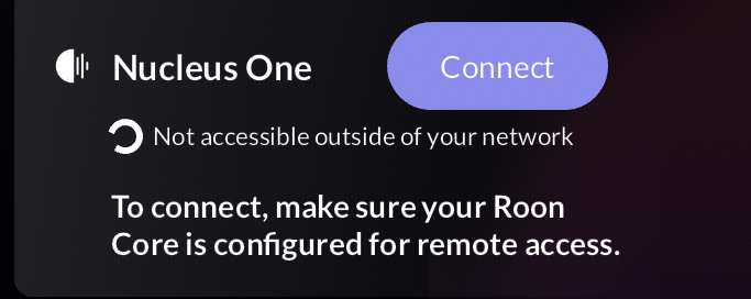

This is expected behavior: ARC checks for port forwarding, not Tailscale, so it may say your Nucleus or ROCK isn't accessible outside your network. If you see that message, please tap Connect anyway.
