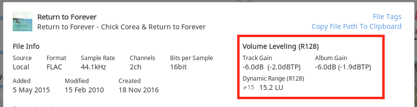

You can see volume leveling information on the File Info popup. This can be accessed by selecting "View File Info..." for a track in your library.
The "dB" numbers represent the volume adjustment that will be necessary to adjust this track or album to the target level of -14LUFS. The "dbTP" numbers represent the "True Peak" level for the track or album. The "Dynamic Range" value reflects the R128 "Loudness Range" for this track. For more information, see our Dynamic Range article.

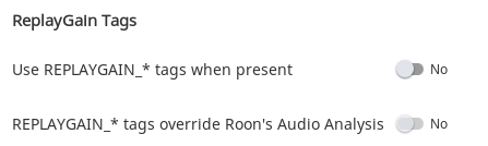

 When REPLAYGAIN_REFERENCE_LOUDNESS is not provided the *_GAIN tags are interpreted relative to an assumed target of -18 dBFS. To turn on this support, go into Settings -> Library -> Import Settings, then enable one or both of these options:
