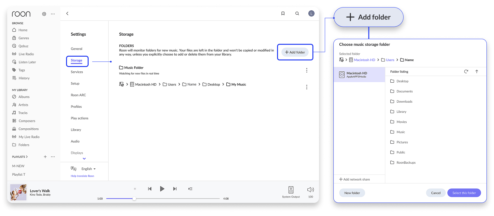

  1. Open Settings, then select Storage.

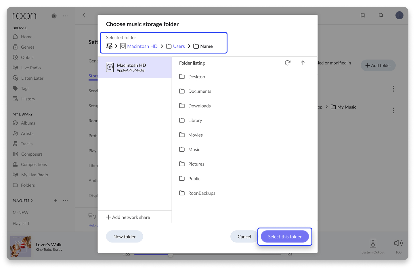

  2. Click + Add folder under the Folders section.
  3. In the Choose music storage folder browser, select the drive and folder where your music lives, then click Select this folder.

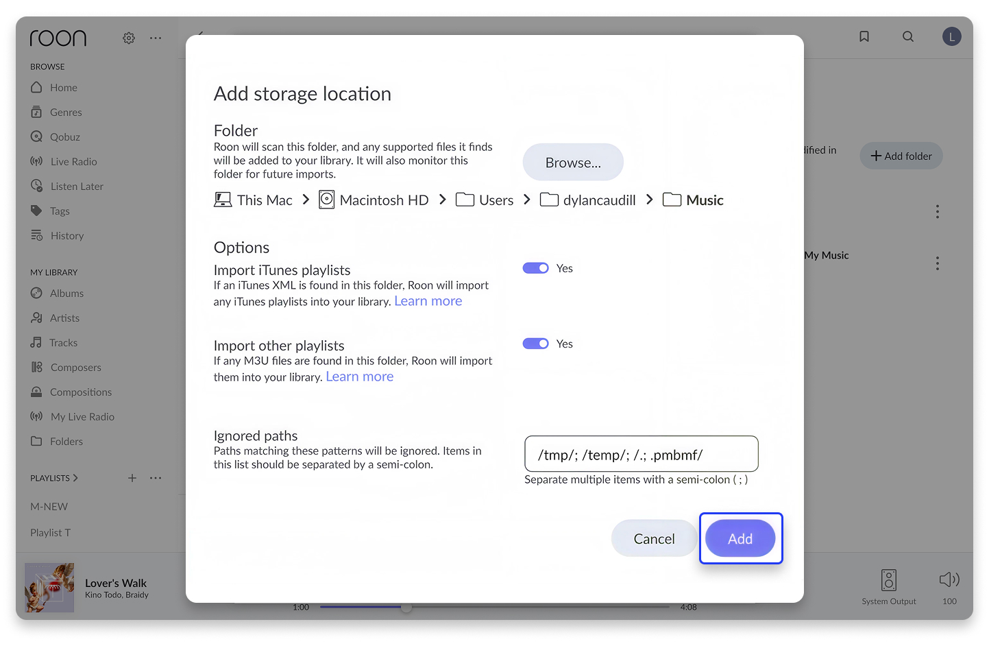

  4. In the Add storage location dialog, confirm the folder shown is correct, or click Browse... to choose a different one. You can also turn on Import iTunes playlists (from an iTunes XML in the folder) and Import other playlists (M3U files), or skip folders using Ignored paths.
  5. Press Add. Your import begins.

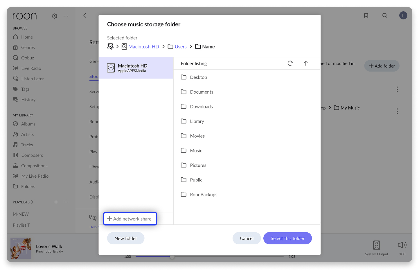

  1. In the Choose music storage folder browser, click + Add network share at the bottom.

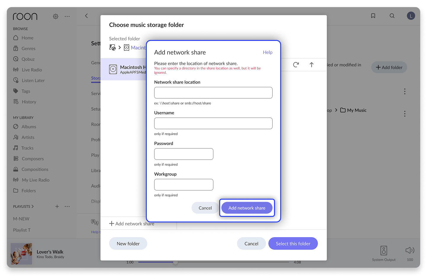

  2. Enter the network path to your shared folder. The path must include the share name, not just the address. For example:
    smb://MyNASDrive/Multimedia/Music
    \\192.168.1.120\Multimedia\Music
  3. Enter your username and password for the share, if required. Depending on your configuration, you may also need to enter "workgroup" in the Workgroup field.
  4. Press Add network share, then Select this folder. Your import begins.

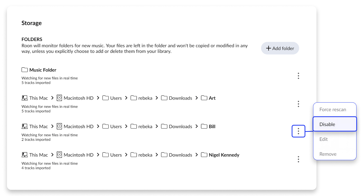

Manage Your Storage Folders
Click the ellipsis next to any folder in Settings, Storage to manage it:
  • Disable: the folder stays listed, but its music is no longer accessible in Roon.
  • Remove: the folder no longer appears in Roon. Your files stay intact.
  • Edit: change the folder's settings or credentials. If your NAS password changes, use Edit to re-enter it.
  • Rescan: check the folder for new or changed files now.
