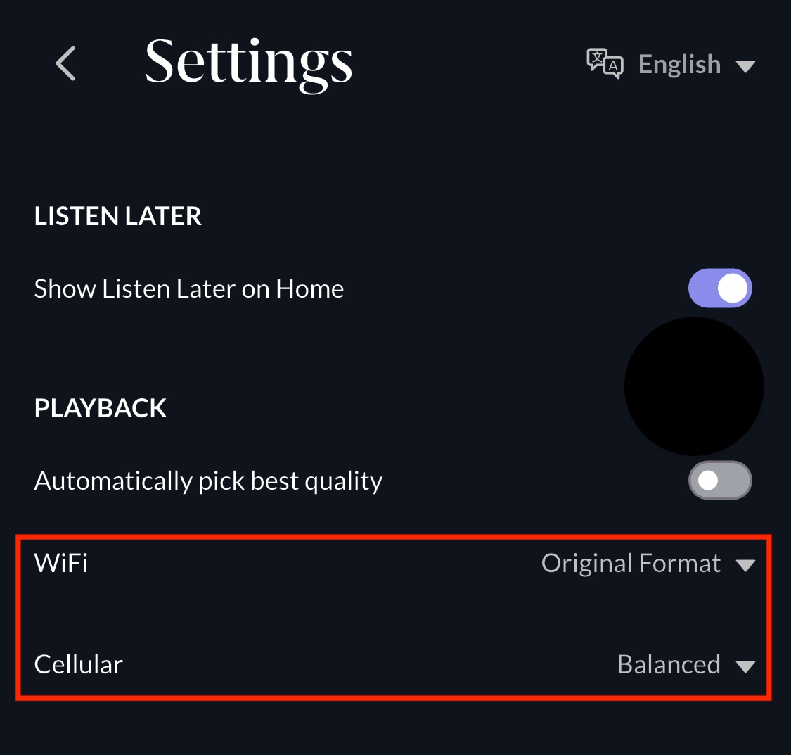

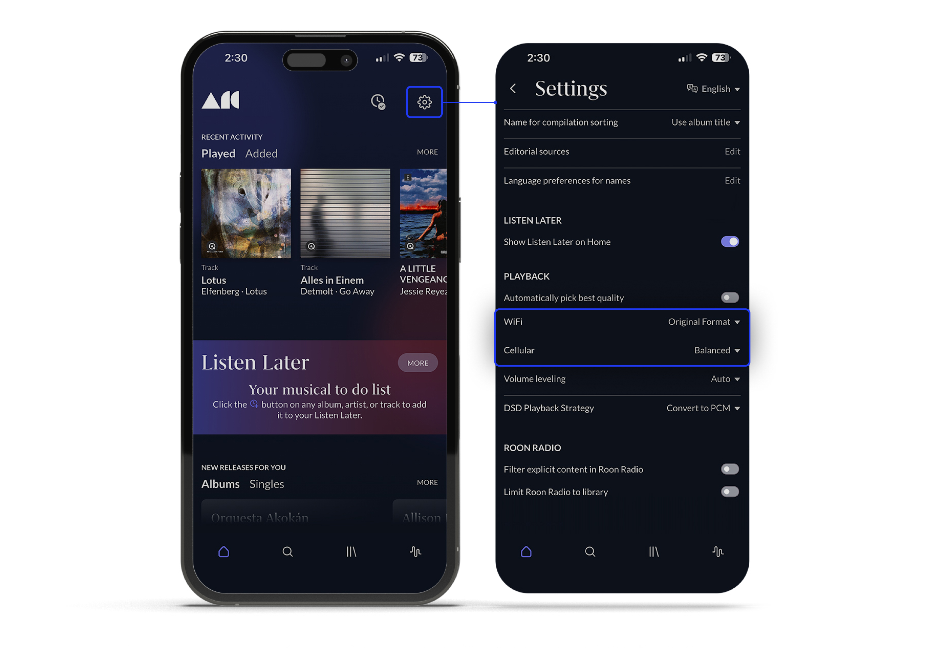

How can I balance sound quality and data usage?
ARC has the same audio infrastructure as Roon. Thus, it has the capacity to send lossless files to a connected USB DAC with uncompromised sound quality.
That said, there might be cases in which lossless audio might be overkill or where mobile data is limited or expensive.
ARC takes this into account, trying to find a balance between conserving mobile data and achieving the best possible sound quality. By default, ARC favors the highest audio quality on WiFi and “Balanced” (usually 320kbps) on mobile data.
If you would like to override this, you are able to adjust these settings.
  1. Under Settings > Playback you will see the option for audio quality and from there you can set exactly the quality level you’d like ARC to use for mobile data or WiFi.
Here’s exactly what our settings mean:
Setting
Result
Best for
Original Format
Best Quality Available
WiFi, when audio quality is prime concern
CD Quality
44.1-48kHz
Very good quality audio
Balanced
320kbits/s
Balance between data-saving and higher quality
Bandwidth Optimized
96-128kbits/s
Slow connections or conserving data

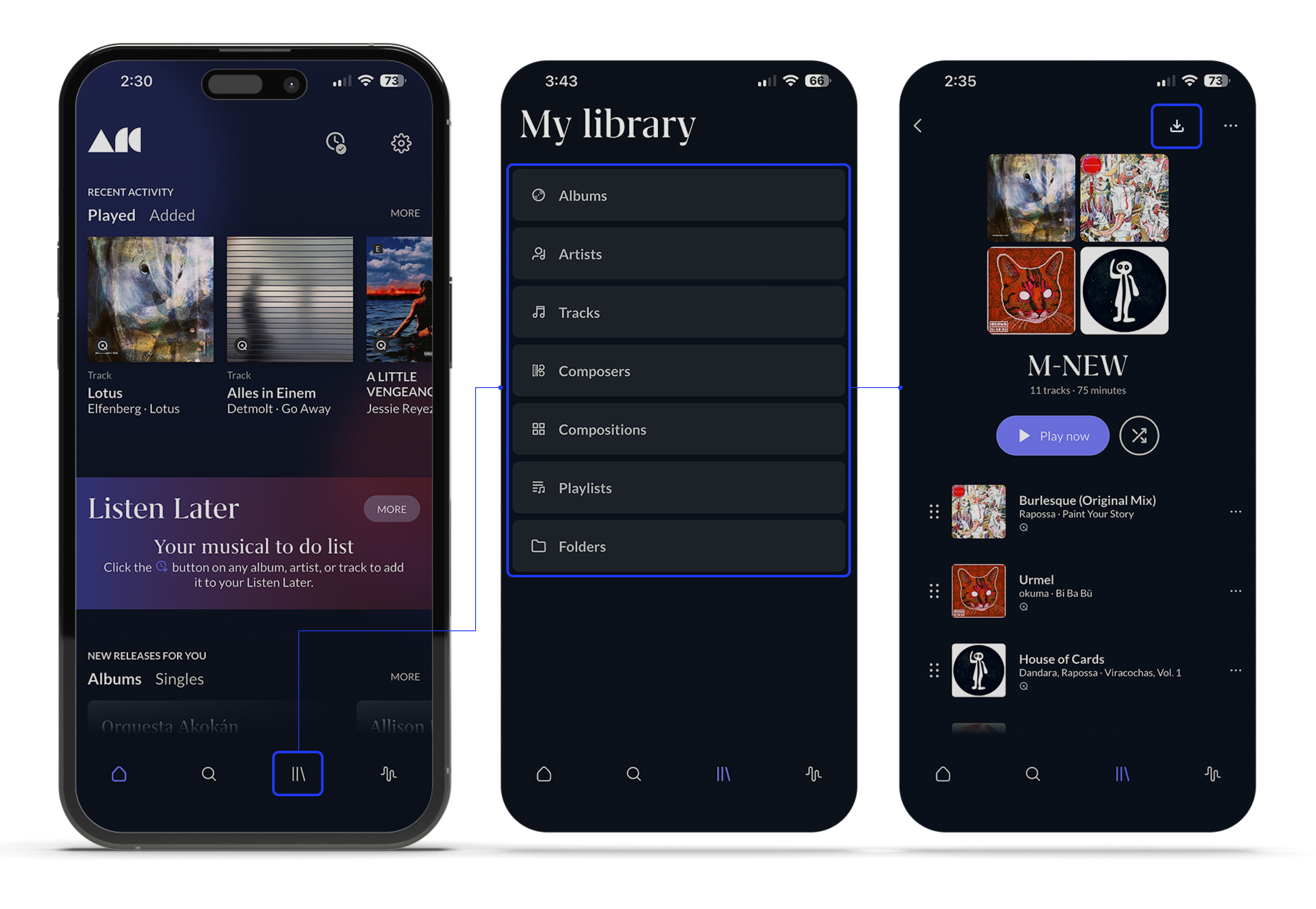

Can I download music for offline listening?
Yes, you can download music from your local music library for offline listening with ARC, click here for our offline listening how-to.
Simply go to any local album or playlist and click the download icon in the top right.
By default, ARC is set to download in original quality and preserve your data by only downloading on WiFi. However, you can override this setting and proceed to download from mobile data.
To do so:
  1. Go to Settings > Downloads and turn off “Download on Wi-Fi Only” or simply attempt to download something on mobile data and ARC will prompt you.
Downloaded content exists on the profile level and will be shared between profiles on the same account.

Can I control this?
Yes, you can use quality settings to control how much bandwidth is used by streaming music. Read below to see exactly what each setting means.
How can I minimize bandwidth usage?
If data is a concern, we recommend using the “Bandwidth Optimized” setting as it has the smallest data footprint.

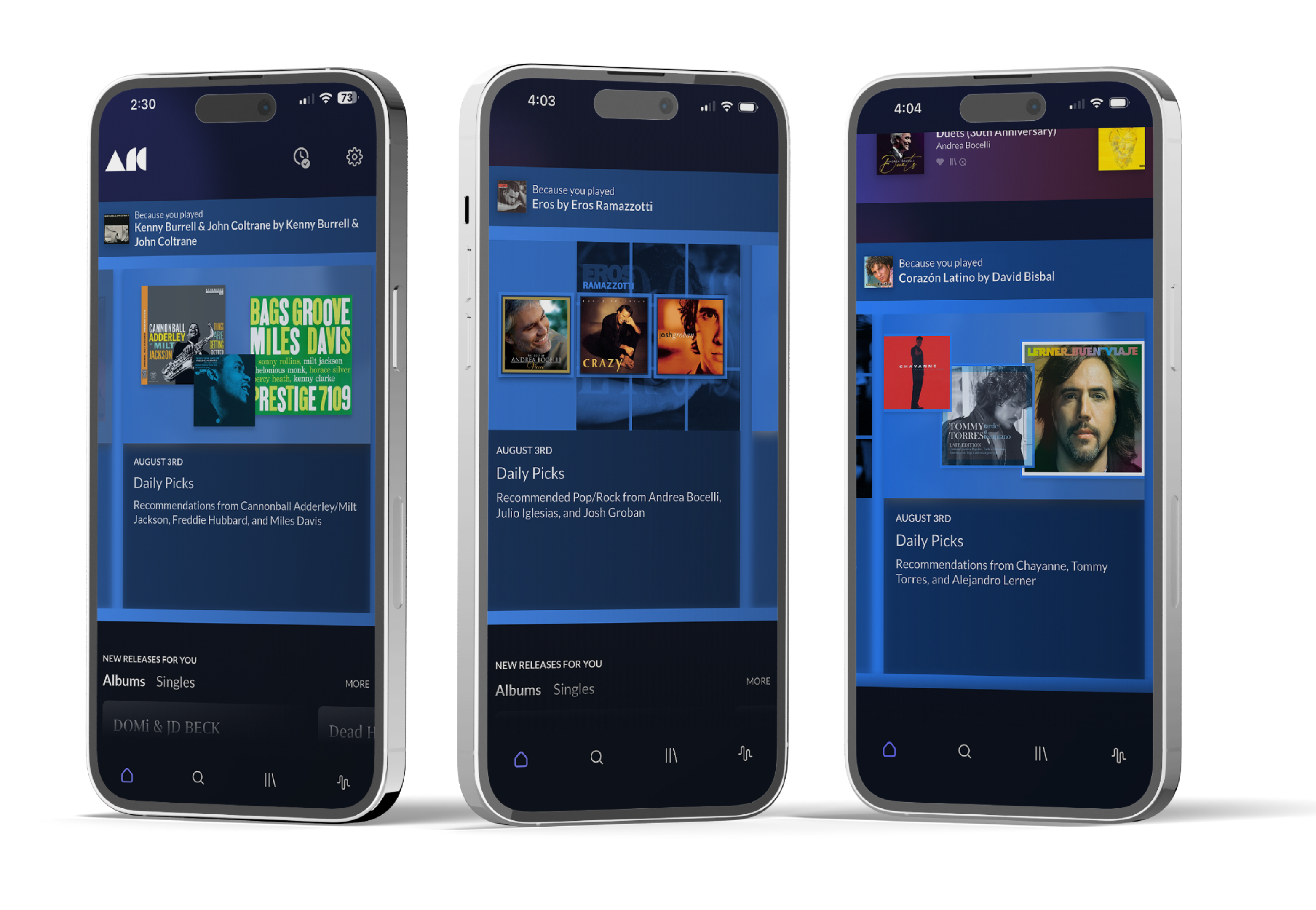

Does ARC have the same Discovery features as Roon?
ARC is connected to Valence just like Roon and offers the same level of personalized curation. Roon Radio is available in ARC, along with personalized recommendations based on your listening history through Daily Picks and New Releases For You.

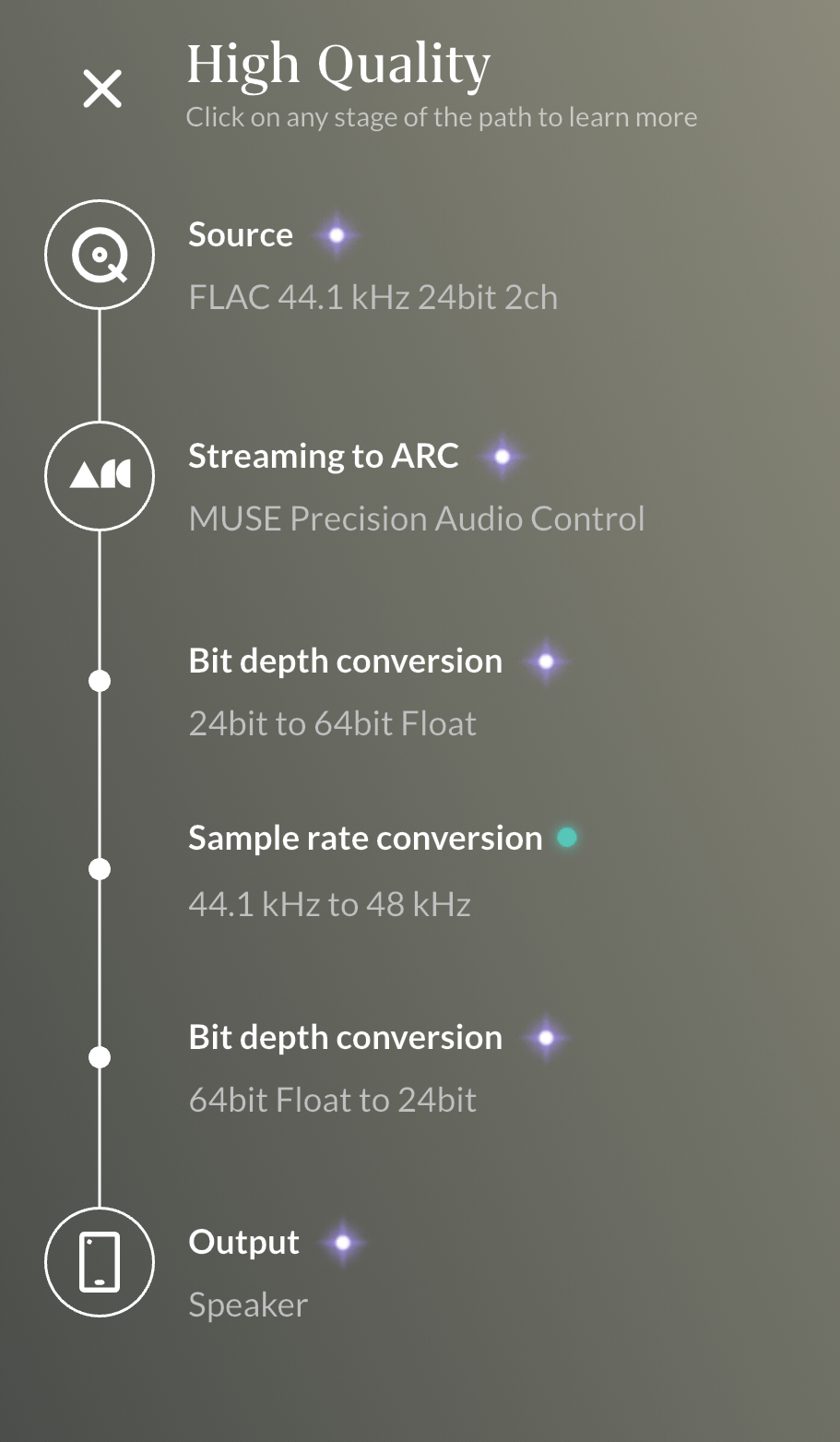

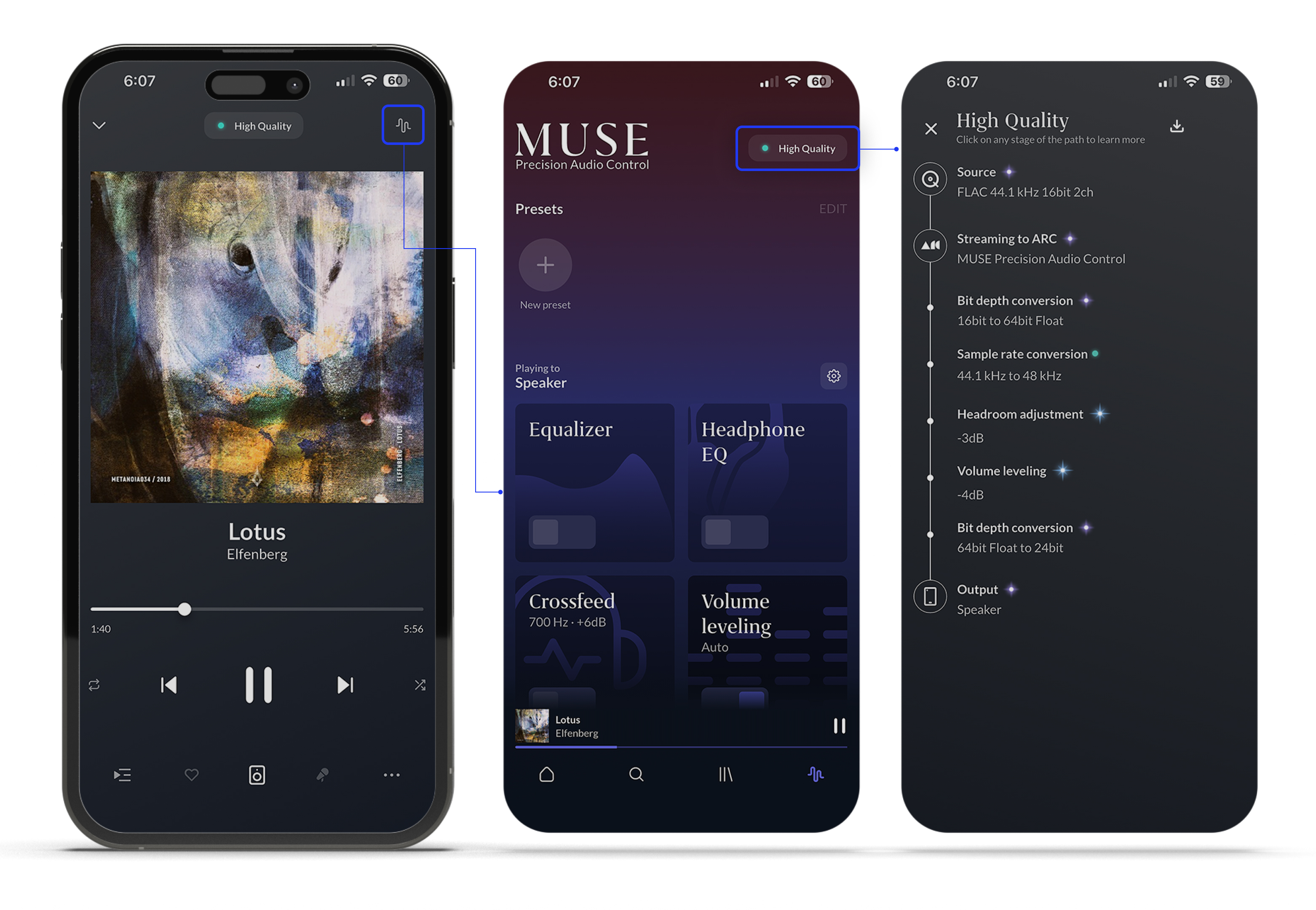

How does ARC play my local files?
Your files are streamed directly from your server.
What happens along the way is determined by your playback quality settings. By default, if you are on a cellular network, the files may be transcoded to a lossy format on the server to save bandwidth. If you are on a wifi network, files are streamed in their original format. These are the defaults, but you are able to customize each quality setting based on whether you’re on mobile data or Wifi.
For already downloaded files, playback settings will have no effect. If you’ve downloaded FLAC, we will play your unadulterated file directly from your phone.
If you have any questions, signal path will transparently show you what is happening at every step along the process.

Can I achieve Bit-Perfect Playback with ARC?
On iOS, we’ve confirmed bit-perfect output to USB DACs supporting DoP playback, MQA DACs, etc.
For Android, the answer is more nuanced. ARC shares Roon’s mobile implementation of RAAT, which uses Android's AAudio framework to deliver an audio signal to the operating system on your device.
Each Android device has a native sampling rate, determined by the operating system or device vendor. If we deliver audio to the device at any other sampling rate, it will be resampled by the system mixer, possibly introducing "bad" signal processes and audio impurities.
To prevent the operating system from interfering with audio quality, Roon detects the native sampling rate of your device and delivers the audio in that format. On most Android devices, this is usually a multiple of 48kHz.
If you would like to pursue the highest audio quality possible on Android, a USB DAC will sometimes yield a higher sample rate than the native rate of the Android device.
For the best playback possible, regardless of platform, you’ll want to disable volume leveling and set your streaming quality preferences to “original format”. You’ll also want to check the playback quality settings. You can always use the signal path to confirm.

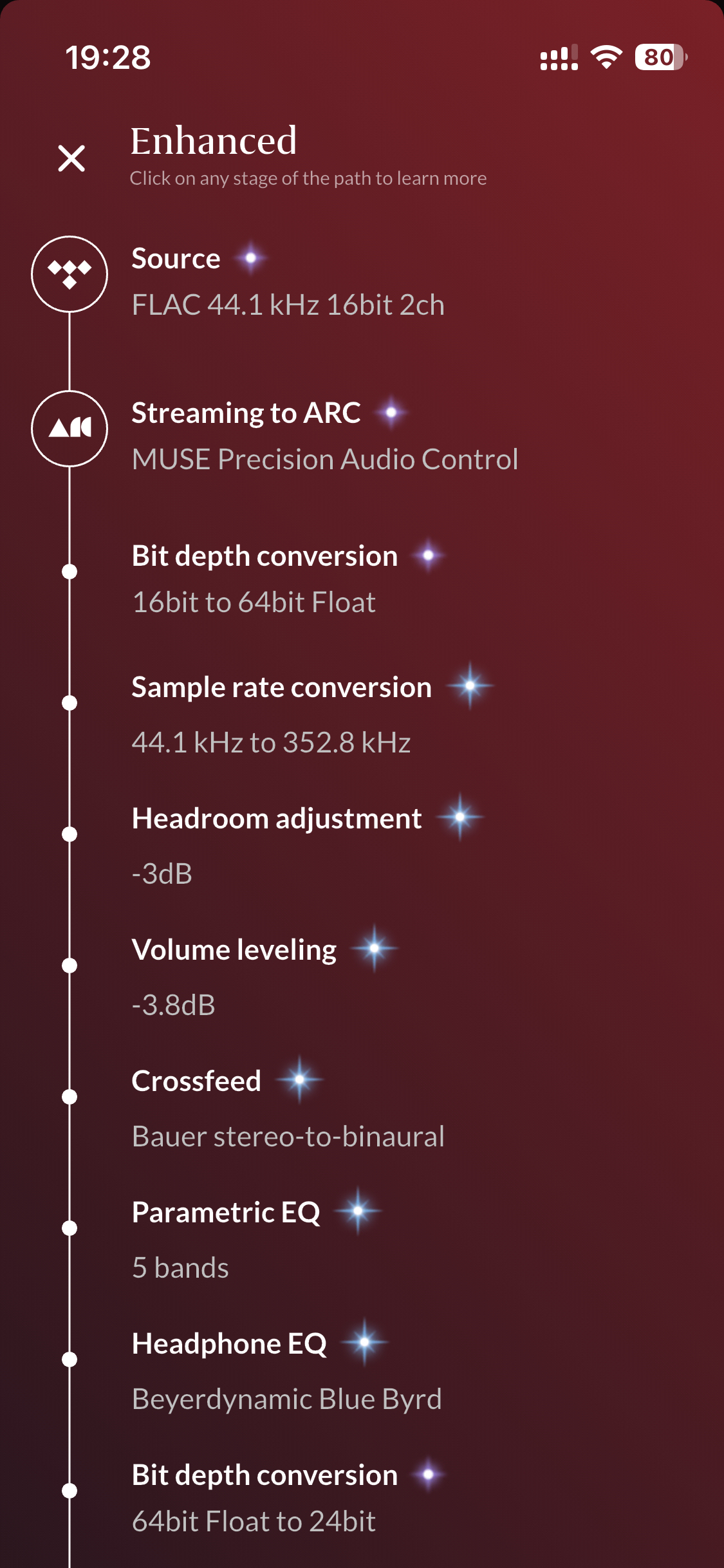

Within ARC, there are some additional steps you can take to ensure your sound quality is as good as it can be. You may want to disable volume leveling, and you’ll also want to ensure your music is playing back in its “original format”, with no additional encoding.
This can be confirmed by checking Signal Path, on the Now Playing screen.
When using mobile data, your music may be reencoded to save bandwidth and ensure stable playback. To stream your files format over mobile data without conversions, you’ll want to change your playback settings to “Original Format”. Note that changing your mobile data settings may significantly increase the amount of mobile data that ARC uses.
Finally, it’s worth noting that right now lossless playback is easier to achieve on iOS than Android, due to the complexity of the Android ecosystem and its audio infrastructure. When configured as noted above ARC will do its best to lossless audio to Android for processing, but the operating system may modify the signal prior to output.
You can always confirm whether you’re playing back losslessly by checking Signal Path, and we look forward to expanding the capabilities of ARC on Android to make lossless playback possible in more scenarios.
